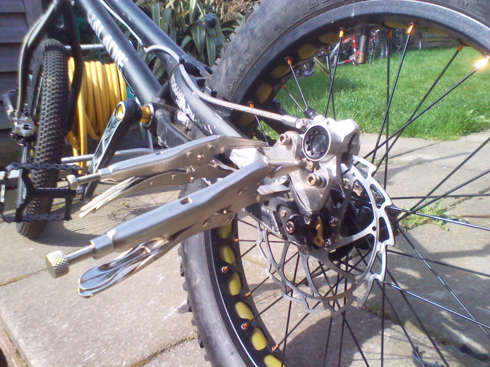

craigjames Posted April 3, 2011 Report Share Posted April 3, 2011 Is that the position it's going to get welded at?! Looks like you didn't listen to Bigman's advice at all... Quote Link to comment Share on other sites More sharing options...
Luke Rainbird Posted April 3, 2011 Report Share Posted April 3, 2011 Are you SURE that caliper is in the right place? Still looks way out compared to the rotor dude. Edit; Haha, Craig replied at the same time I did, but yeah, still stands. Quote Link to comment Share on other sites More sharing options...
dirt jumper jake Posted April 3, 2011 Author Report Share Posted April 3, 2011 Yeah looks shocking in that photo, the angle isnt 100% but it still uses 95% of the pad so im happy Quote Link to comment Share on other sites More sharing options...
