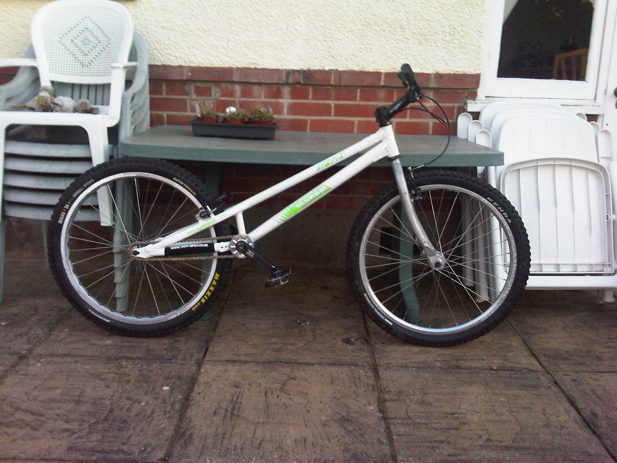

saunders Posted March 25, 2011 Report Share Posted March 25, 2011 (edited) Just got it built up yesterday. It feels very different to the old koxx levelboss 1065, but shouldn't take too long to get use to it. Edited March 25, 2011 by saunders Quote Link to comment Share on other sites More sharing options...
isitafox Posted March 25, 2011 Report Share Posted March 25, 2011 (edited) Nice, I'm loving mine. Looks good in white as well! How did you find setting the rear wheel up and what's that tyre like for clearance?? Edited March 25, 2011 by isitafox Quote Link to comment Share on other sites More sharing options...

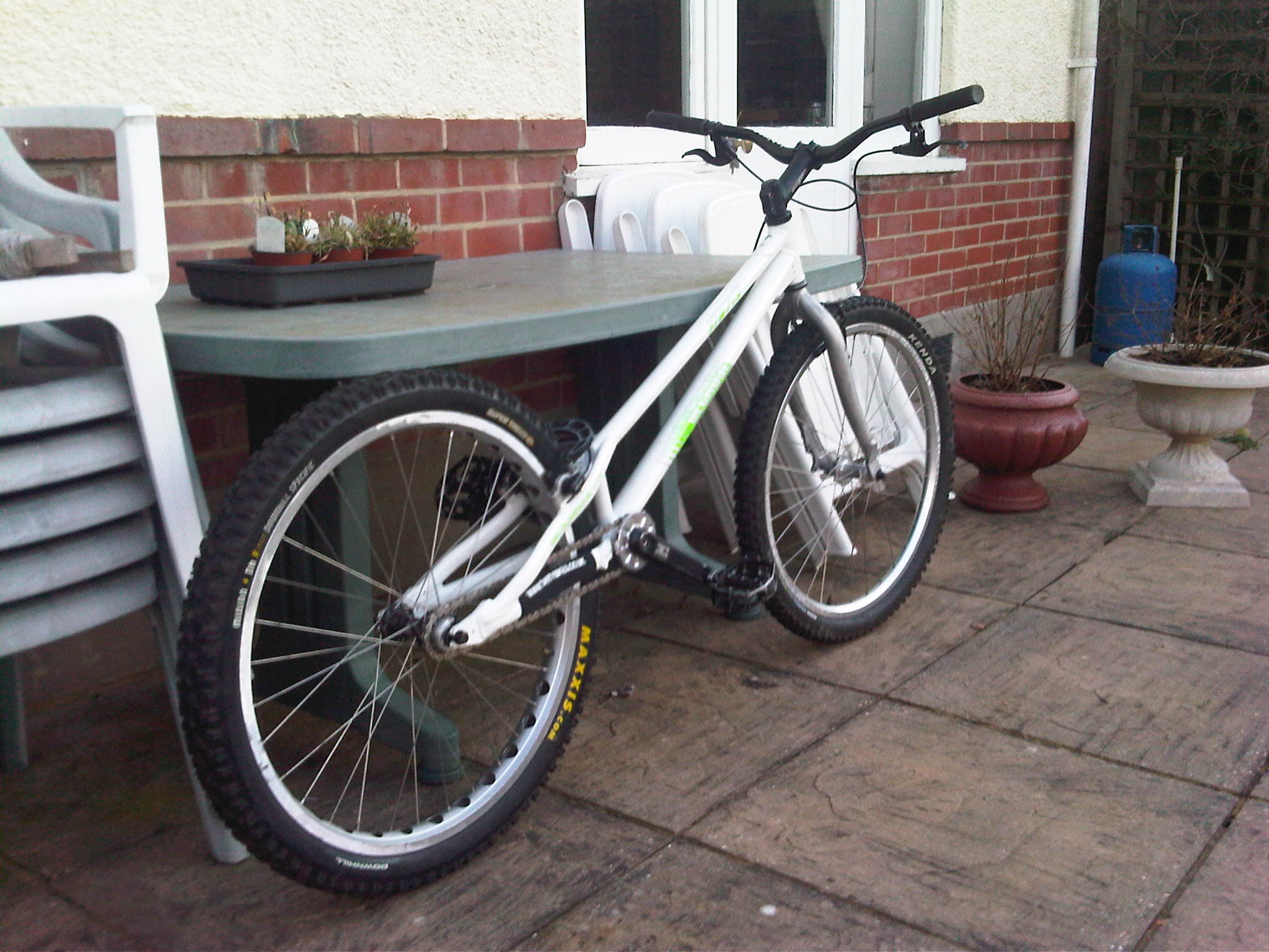

saunders Posted March 25, 2011 Author Report Share Posted March 25, 2011 (edited) Nice, I'm loving mine. Looks good in white as well! How did you find setting the rear wheel up and what's that tyre like for clearance?? Cheers, Wasn't really much of a problem setting up the rear wheel. I'm using Rockman notched snail cams which i guess are a little easier to set up than the smooth edged cams. I just adjusted the drive side first to get the chain tension right then used the none drive side cam to centralise the wheel in the frame. Tyre clearance is definately at a premium, I'm running a minion 2.5 and had to set the wheel pretty far back in the drop outs to get is to clear. Edited March 25, 2011 by saunders Quote Link to comment Share on other sites More sharing options...
isitafox Posted March 25, 2011 Report Share Posted March 25, 2011 They'll be the same as what I'm running, managed to blag some old Tryall toothed cams off ali c as 20mm wasn't enough adjustment and they were the only ones bigger. And I've got a der kaiser on the rear but it had to be 'adjusted' slightly with a stanley knife to fit! I really enjoy riding the frame though, very nice in my opinion! Quote Link to comment Share on other sites More sharing options...
