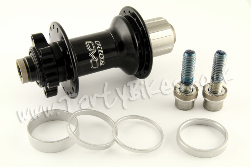

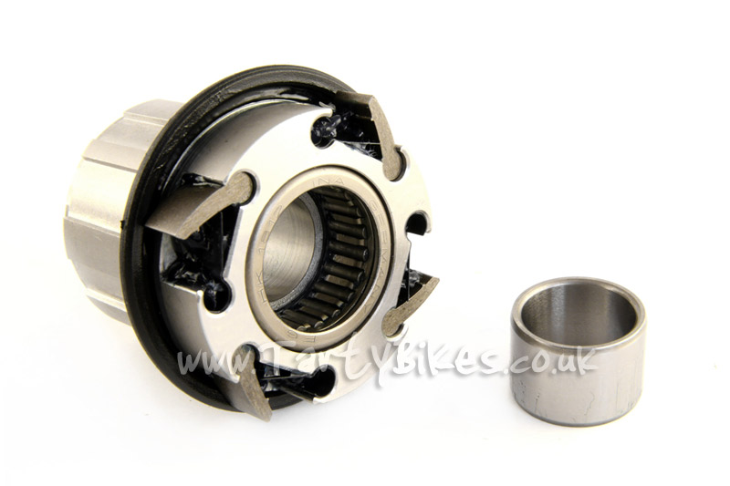

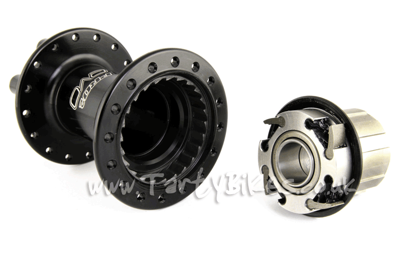

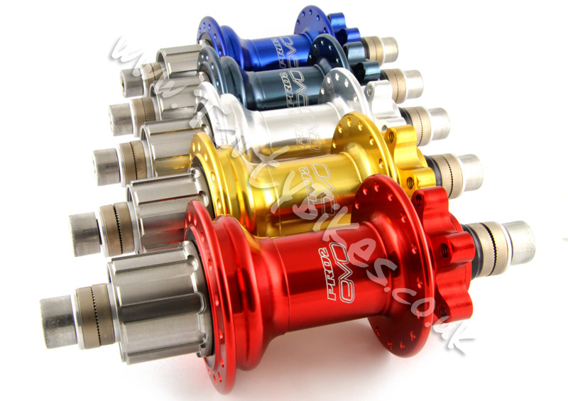

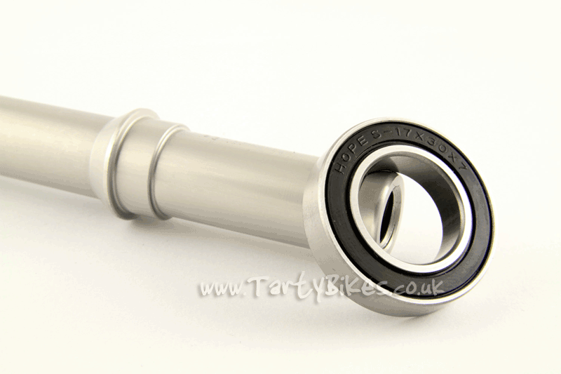

Mark W Posted March 24, 2011 Report Share Posted March 24, 2011 Hope have updated the Pro 2 T for 2011, creating the Pro 2 Evo Trials hub. Still using the same basic engagement system before, with steel freehub body and beefed up hubshell, but now featuring a needle roller bearing in the freehub body as standard, and with higher quality Hope-branded bearings inside the hub itself. They also come as standard with the stronger, 8mm allen key broached axle bolts that are a load tougher than the older, 6mm versions. Quote Link to comment Share on other sites More sharing options...

Ash-Kennard Posted April 10, 2011 Report Share Posted April 10, 2011 if i bought a pro 2t earlier this year, and eventually wanted to change the bearings, are the needle bearings the same size as the roller bearings in the older models? 2 Quote Link to comment Share on other sites More sharing options...
J.KYDD Posted April 11, 2011 Report Share Posted April 11, 2011 if i bought a pro 2t earlier this year, and eventually wanted to change the bearings, are the needle bearings the same size as the roller bearings in the older models? Nope, the new freehub body is different to accomodate the new bearings. I asked Hope this question a while ago. Quote Link to comment Share on other sites More sharing options...

ecols Posted April 15, 2011 Report Share Posted April 15, 2011 So, is the ratchet still 2 pairs of claws? And is it possible to rebuild the Hub with the 12mm through-axle kit? Planned to do this a while ago, but really can't convince myself 2 claws are better than 4 at a time.. -.- Quote Link to comment Share on other sites More sharing options...
aener Posted April 26, 2011 Report Share Posted April 26, 2011 That hubshell looks dangerously similar to the ProIIt's the one before last that cracked all the time Hope it IS beefier Quote Link to comment Share on other sites More sharing options...
Mikee Posted April 26, 2011 Report Share Posted April 26, 2011 (edited) If pro2s used different springs and moved some stuff about could another set of 2 pawls be fitted in there to give more engagement? I am always thinking it when i am servicing mine. Has anyone else thought that? Edited April 26, 2011 by Mikee Quote Link to comment Share on other sites More sharing options...
Ali C Posted April 26, 2011 Report Share Posted April 26, 2011 would make an already heavy hub heavier though. I don't really feel a lack of engagements when I am riding either. I would rather see them slim down the hub a bit instead, there is no need to have room for 6spd now the rules for comps have changed, making it a true singlespeed could save a fair lump of steel. 4 Quote Link to comment Share on other sites More sharing options...
Mikee Posted April 26, 2011 Report Share Posted April 26, 2011 (edited) Do that then add another 2 pawls. Then it would be 72 ep yeh? same as a king. Surely 2 more pawls wouldn't make it noticably heavier though? Edited April 26, 2011 by Mikee 1 Quote Link to comment Share on other sites More sharing options...
Trials Punk Posted April 27, 2011 Report Share Posted April 27, 2011 That hubshell looks dangerously similar to the ProIIt's the one before last that cracked all the time Hope it IS beefier You mean the ones without the reinforced 'bulge' on the driveside, which these new ones clearly have? Do that then add another 2 pawls. Then it would be 72 ep yeh? same as a king. Surely 2 more pawls wouldn't make it noticably heavier though? Increasing the pawl count is going to increase the resistance to the wheel freewheeling, to coutner that they would have to put softer springs in. I'd rather 4 pawls. Quote Link to comment Share on other sites More sharing options...
