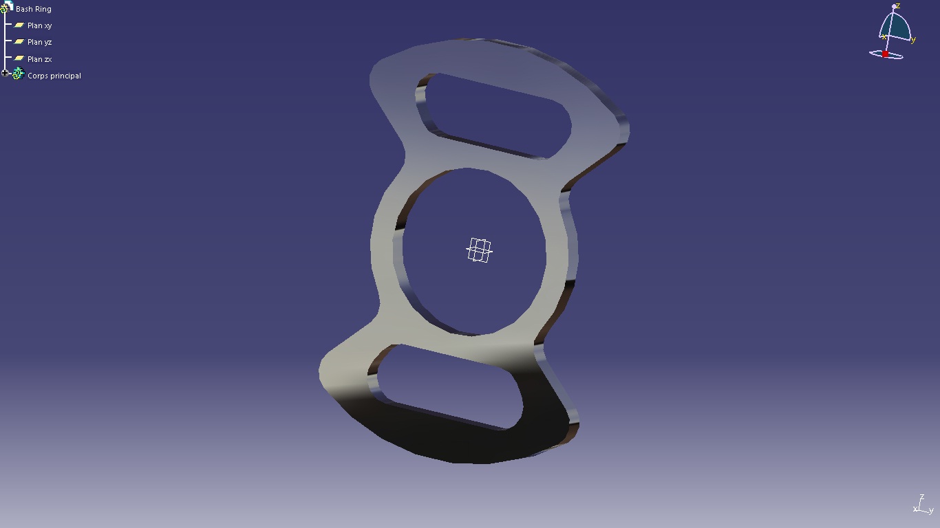

I have now finished designing it on CATIA. Here is a pic. I'll have it tomorrow if everything goes well.
Tell me what you think!
Edited by Canardweb
Looks good though I think it would look better if the lightening holes followed the curvature of the ring rather than running straight.
Yes I thought of that. I am only doing it as a simple prototype though. I'd like to keep the geometry simple for the program first!
Also I'd like to keep the outer edges quite wide so they resist better to shocks. I I just use the shape of the outer edges, I'll have to change the geometry in the part. That means more lines in the Plasma cutter machine program, and more mistakes that can be done.

Unless it's gonna be steel, that will deform pretty quickly... you need some sort of 'bracing' in the big hole.
Bracing? What do you mean?
This is another project I have in mind. I would cover it with carbon fiber to make it more resistant.
Alone, this rim is 382 grams. With carbon, it would be like 500 grams maximum!

And what I believe Adam means is change the design a little so it's more like this
post-24247-0-14724200-1300219003_thumb.j
I apologise for the ropey paint drawing!!
I see what you mean. I'll see what I can do. I won't probably do these holes you know. SO it looks more like that:
