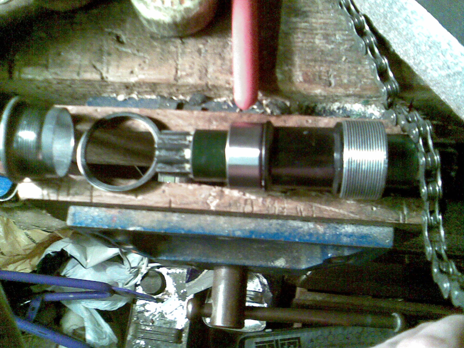

crashbanggg Posted March 4, 2011 Report Share Posted March 4, 2011 Iv taken my old BB out and in the process of putting a new (Well new to me) BB in. The book im following (Haynes Bike Book) says I should screw the drive side in first ANTI-clockwise, followed by the other side. However it doesnt seem to want to go in... Any suggestions? And am I right in thinking this is the right way to put it together once in the bike? (With the chain representing the drive side) Quote Link to comment Share on other sites More sharing options...
LukasMcNeal Posted March 4, 2011 Report Share Posted March 4, 2011 Driveside is the opposite end, the end where the cup has a collar and there is also a spacer. You will need to remove the non drive side (sleeveless cup) to insert the BB first. Quote Link to comment Share on other sites More sharing options...
crashbanggg Posted March 4, 2011 Author Report Share Posted March 4, 2011 Driveside is the opposite end, the end where the cup has a collar and there is also a spacer. You will need to remove the non drive side (sleeveless cup) to insert the BB first. Thanks That'd probably explain why it wasn't going in... Quote Link to comment Share on other sites More sharing options...
