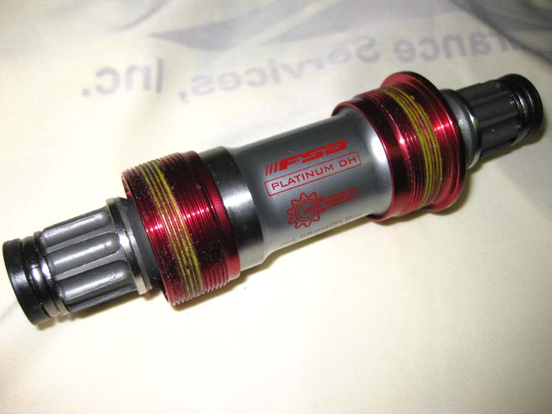

Ateam Posted March 2, 2011 Report Share Posted March 2, 2011 A basic BB tool is pretty cheap, like $10 dollars US. The BB tool made by FSA is a bit longer than most so it will work on all longer BB axles (I'm discussing ISIS BB). It works so perfectly and easily, no buggering your threads and it will be an essential tool for basic bike work. Otherwise take it to your shop and watch, ask questions and then have them sell you the BB tool. This picture is removing a 7 month old destroyed FSA Platinum down hill BB: Quote Link to comment Share on other sites More sharing options...
dmiller403 Posted March 2, 2011 Report Share Posted March 2, 2011 ^cant go wrong with the right tool. Ill have to look for the fsa version. I have a parktool and it does seem to be at the tip of the blades when finishing tiightening. Could potentially cause problems when trying to loosen it, especially when theres an aluminum bb shell involved. Quote Link to comment Share on other sites More sharing options...
