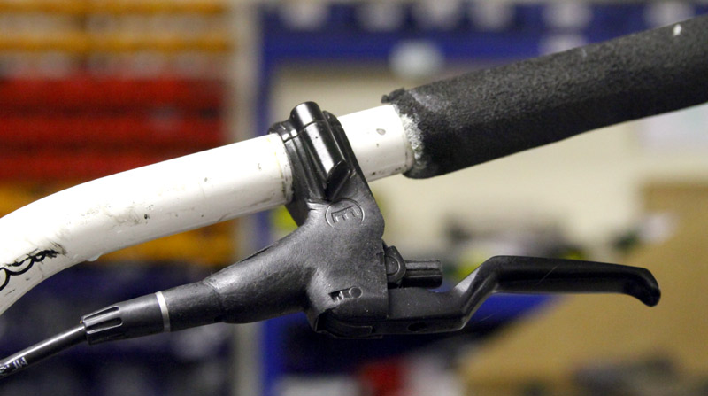

Mark W Posted February 22, 2011 Report Share Posted February 22, 2011 You can't actually buy the HS11 from Magura with anything other than the 4-finger blade on. The HS33 is available from them in 2 or 4 finger blades, but we don't stock the 4-finger blade as there's not really any point when the HS11's so much cheaper. Out of the two, because of the HS11 having the long blade giving it more power it can result in a slightly spongier brake if you've got a flexier frame/no booster. Because of that, if you prefer a stiffer feeling brake I'd recommend the HS33. Ali put one on a week or so ago and it does feel really good. Ali also took a file to his and reshaped it a little: Quote Link to comment Share on other sites More sharing options...
