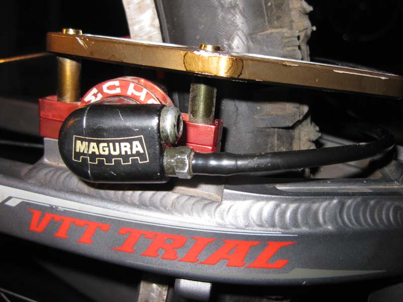

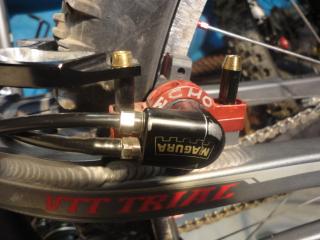

I had a similar problem with my rear brake mounts. I was running a 4 bolt booster on a stock Meta with HS33. The left rear frame mount stripped out. I was able to run a bit longer M5 after filing it down that connected with the bottom set of frame brake mount threads. The top few threads are stripped, not the complete set of threads. My bike is a Meta (stupid strong) and the main purpose of the booster was to protect the brake line cross over, not so much for stability/frame flex. So I picked up a 2 bolt booster and was able to run my original M5 bolt and used the booster spacer on the bad threaded brake mount. It works fine but soon to install 4 heli-coils to get rid of the long M5 and spacer.
