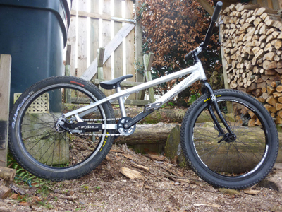

Miles Mallinson Posted February 4, 2011 Report Share Posted February 4, 2011 Some frames look great raw, use nitromorse that works better than spending hours sanding it or get it professionally sand blasted. It might take a while to nitromorse a glossy frame the paint is abit stronger/ Mine before and after: Quote Link to comment Share on other sites More sharing options...
