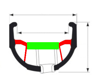

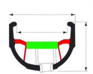

AndrewG Posted January 28, 2011 Report Share Posted January 28, 2011 (edited) My bro did and he is fine took him approx.2hours though... it was less that 2hours and don´t forgot to saw it slightly first and do not remove the side chamber !!! remove only that part on the rim which is green on pics BTW you can save 60-70grams ;-) + you can make square holes and that can saves next 20-30 grams so finally you can save 100g Edited January 28, 2011 by AndrewG Quote Link to comment Share on other sites More sharing options...
