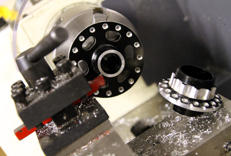

AdamR28 Posted January 31, 2011 Author Report Share Posted January 31, 2011 Rear hub broke Lathe to the rescue! Gonna have to make a mandrel so I can make a carbon sleeve that's the right size... Will update further when I've done more if anyone's interested. Quote Link to comment Share on other sites More sharing options...

davey1991 Posted February 1, 2011 Report Share Posted February 1, 2011 Be interesting to see the final results. How are you planning on bonding it to take the twisting forces? Quote Link to comment Share on other sites More sharing options...
AdamR28 Posted February 1, 2011 Author Report Share Posted February 1, 2011 Yeah got a small lathe, great fun to play with! Will just bond the carbon on, there shouldn't be much force on it since the spokes will take that. Quote Link to comment Share on other sites More sharing options...

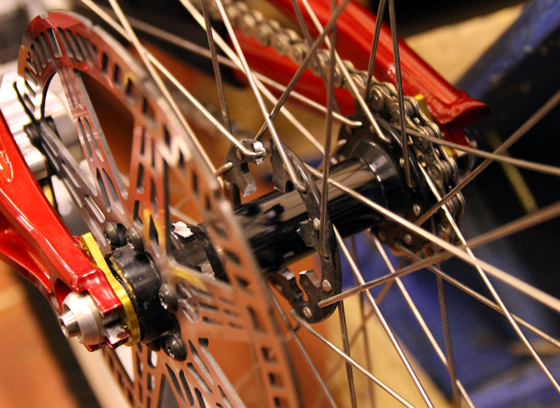

Krisboats Posted February 1, 2011 Report Share Posted February 1, 2011 That rear drop out looks like a bit of a handful.... 4 Quote Link to comment Share on other sites More sharing options...

Alex Dark Posted February 8, 2011 Report Share Posted February 8, 2011 Looks great Ads, how did you go about machining the axle washers down? use the bolt to clamp it then use the bolt in the lathe? Quote Link to comment Share on other sites More sharing options...
AdamR28 Posted February 8, 2011 Author Report Share Posted February 8, 2011 Just clamped them 'as normal'. Quote Link to comment Share on other sites More sharing options...

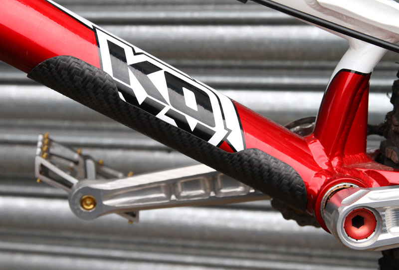

AdamR28 Posted February 9, 2011 Author Report Share Posted February 9, 2011 Knocked up a downtube guard too, moulded around the frame for a perfect fit. 0.75mm thick around the edges (2 layers) and 2mm (6 layers) down the centre to fend off knocks (hopefully!). Weight is 25g and clips on and off without the need for any sort of sticky pad Reminds me of a sanitary towel though Quote Link to comment Share on other sites More sharing options...
George6512 Posted February 9, 2011 Report Share Posted February 9, 2011 Looking good . I like the postion of the disk mounts on the frame hidden next to the dropouts, those brakes are insane! Quote Link to comment Share on other sites More sharing options...
