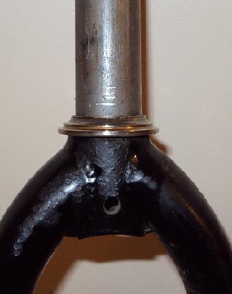

bikeperson45 Posted January 19, 2011 Author Report Share Posted January 19, 2011 Basically, I'm thinking I need the correct size crown race. Here's some pictures and I'd like to remind you I'm awful at all mechanical things. I also have a little bearing thing that's got a gap on presumably to help get it on the steerer, where does this go? Thanks Quote Link to comment Share on other sites More sharing options...
Matt Burrows Posted January 19, 2011 Report Share Posted January 19, 2011 lol yeah you got it, crown races are specific to each headset. If you change forks or headset, you need to switch the crown race over. 1 Quote Link to comment Share on other sites More sharing options...

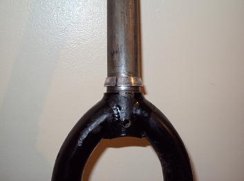

bikeperson45 Posted January 19, 2011 Author Report Share Posted January 19, 2011 Ah, okay then. Took the old crown thing off and I think this is the right one for the headset? And assuming it is how do I get it to the bottom of the steerer without damaging it? I've tried a screwdriver and hammer but any other suggestions? Thanks Right crown race for the Echo headset? Quote Link to comment Share on other sites More sharing options...
isitafox Posted January 19, 2011 Report Share Posted January 19, 2011 With the split in it should go down with a little force Quote Link to comment Share on other sites More sharing options...
bikeperson45 Posted January 19, 2011 Author Report Share Posted January 19, 2011 With the split in it should go down with a little force What if it's not? Do I need a bigger size? Thanks Quote Link to comment Share on other sites More sharing options...
isitafox Posted January 19, 2011 Report Share Posted January 19, 2011 Shouldn't think so, that looks like the one I had with my Echo headset. Just needed tapping down onto the wider part of the steerer. Think there's only one size as all the headsets are 1 1/8" 1 Quote Link to comment Share on other sites More sharing options...

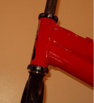

bikeperson45 Posted January 19, 2011 Author Report Share Posted January 19, 2011 Sorry, I'm a complete idiot, your right. However, now the problem is they're in but they don't turn freely, when I push them they'll only turn a quarter around. I can hear rubbing, solutions? Thanks again Quote Link to comment Share on other sites More sharing options...
Azarathal Posted January 19, 2011 Report Share Posted January 19, 2011 Rubbing is top cap too tight normally. Sounds like you're biting the bearings. Quote Link to comment Share on other sites More sharing options...
Matt Burrows Posted January 20, 2011 Report Share Posted January 20, 2011 Ah, okay then. Took the old crown thing off and I think this is the right one for the headset? And assuming it is how do I get it to the bottom of the steerer without damaging it? I've tried a screwdriver and hammer but any other suggestions? Thanks Right crown race for the Echo headset? That looks more like the compression ring to me? How well does it fit together now? There shouldn't be any rubbing! It should spin very easily, something is very wrong. Quote Link to comment Share on other sites More sharing options...
N.Wood Posted January 20, 2011 Report Share Posted January 20, 2011 As Matt said, that looks like the compression ring. There should be one that looks the same/similar as the one you took off the forks. The compression ring is what goes at the top usually just under the stem or under a bearing cover. Maybe photograph all the parts you have and we can point you in the right direction? Quote Link to comment Share on other sites More sharing options...
AdamR28 Posted January 20, 2011 Report Share Posted January 20, 2011 Right crown race for the Echo headset? Unfortunately not - that looks more like a top compression wedge from an FSA Pig than a bottom wedge from an Echo headset. The Echo's lower wedge is steel (that looks alloy on the picture), and the top one should be black and aluminium. Did you get the headset 2nd hand? That might explain it... Quote Link to comment Share on other sites More sharing options...

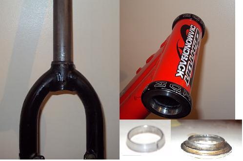

bikeperson45 Posted January 20, 2011 Author Report Share Posted January 20, 2011 Okay, so I have another of those rings that is now acting as a crown race for my fork which seems to be a compression ring. When I took the Echo forks that were previously used with this headset I don't think there was a crown race at all? Would that work, because nothing was attached to the fork like it was for the pair I'm attempting to put on. Here's a picture of everything, which is very little but here it is anyway. There's also a picture of the crown race for the other FSA headset. Thanks for all the help. Quote Link to comment Share on other sites More sharing options...
bikeperson45 Posted January 21, 2011 Author Report Share Posted January 21, 2011 Bump please Can I continue to use that compressor ring or should I get a new crown race, and if so which one for that Echo headset? It was bought second hand so's it possible he bodged it that way? Thanks Quote Link to comment Share on other sites More sharing options...
davey1991 Posted January 22, 2011 Report Share Posted January 22, 2011 Bump please Can I continue to use that compressor ring or should I get a new crown race, and if so which one for that Echo headset? It was bought second hand so's it possible he bodged it that way? Thanks You really should buy a new crown race, there very little money and it will save you a whole lot oh hassle. Quote Link to comment Share on other sites More sharing options...
