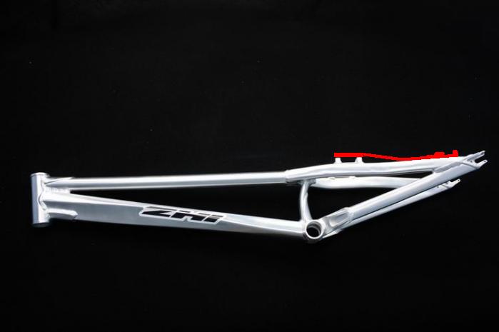

Luke Dunstan Posted January 15, 2011 Report Share Posted January 15, 2011 (edited) why not? this would be a very good system for trials ridersinstead of having to spend fortunes on upgrading frames and the rest of parts that would be needed. personally in my opinion i think this would be a great idea if a company decided to make one of these brackets, after we are only just out of a recession and with tax and all the other cons the government are running it should all ready be out. And asking for validation should not make it take longer it just puts off trials riders from joining as i got recommended by two friends who no longer use the site because of the validation rule as they were on here for 2 months and still never got validated after making numerous posts and comments So you want a system, that screws into a magura 4-bolt, that would hang down the frame, and allow a disc calliper to to be used?? like this... Edited January 15, 2011 by xDUNSTANx Quote Link to comment Share on other sites More sharing options...

Jon Alty Posted January 15, 2011 Report Share Posted January 15, 2011 (edited) That bracket is going to have to be so long, its going to either be really flimsy + flex loads, or weigh a tonne :\. Your best off either keeping maggies or getting a new frame. You could get a disc mount welded onto your frame, but thats going to be expensive i imagine. Also you your comment about there should already be a bracket made, alot of frames come with both disc + 4-bolt mounts anyway, and alot of people prefer HS33 on the back as opposed to disc. So theres not going to be very much demand for such a bracket, making it more expensive to make (as you cant mass-produce). Also asking for validation is off-putting. Your friends cant have made that many topics, if you just post in new members chat, helping people as best you can etc, then your going to get 5 votes pretty quickly... Edited January 15, 2011 by Jon Alty Quote Link to comment Share on other sites More sharing options...

Luke Dunstan Posted January 15, 2011 Report Share Posted January 15, 2011 (edited) http://www.rocknrollbikes.com/trials/brake-parts/onza-disc-brake-converter.html Christ, my blueprints are true! So you'd need vee adaptors then this ugly contraption just to use a disc brake? Save the hassle and get a Maggie. This is a great solution when you want to fit disc brakes to that old school frame with no disc mounts. Fits 90% of old alloy frames with conventional pressed plate rear dropouts. May be a problem if the dropouts are not flat around the dropout where the wheel axle fits. ie CNC side webs etc. Edited January 15, 2011 by xDUNSTANx Quote Link to comment Share on other sites More sharing options...
Jon Alty Posted January 15, 2011 Report Share Posted January 15, 2011 (edited) Christ, my blueprints are true! So you'd need vee adaptors then this ugly contraption just to use a disc brake? Save the hassle and get a Maggie. I agree. That thing is ugly as . Also you need vertical dropouts, which your mod does not have . Cant believe such a contraption exists lol. Edited January 15, 2011 by Jon Alty Quote Link to comment Share on other sites More sharing options...
