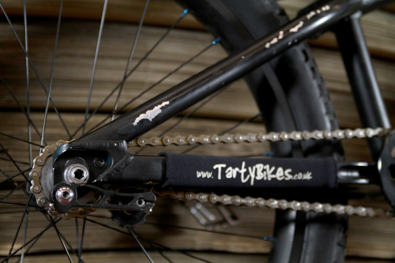

jambo Posted January 14, 2011 Report Share Posted January 14, 2011 Mark looks like he got it sorted. looks good eh? Quote Link to comment Share on other sites More sharing options...
forteh Posted January 14, 2011 Report Share Posted January 14, 2011 I made a fixed tensioner out of a piece of plastic (ultra high molecular weight polyethylene to be precise, but most chunks of nylon will work), cut a chain guide into the end of it and mounted it to an aluminium angle bracket via an M4 allen screw through the chainring bolt that holds the mech hanger on. Because the plastic has a fair amount of give in it, it acts as a sprung tensioner, Ive not landed on it yet in the 2 years Ive been using it and its never lost tension Quote Link to comment Share on other sites More sharing options...

Mark W Posted January 14, 2011 Report Share Posted January 14, 2011 My Trialtech sprung tensioner (now part of The World's Most Advanced Spoke Tensionerâ„¢ up there) was pretty much faultless the entire time I had it. Works better than almost all other ones out there because of it's 'pinless' design so you can get it ultra low profile so it's nice and out of the way. You could always switch to a K810 (or get a Lite/610HX) and be able to run a plethora of tensioners whilst still having a chain the same strength too. Quote Link to comment Share on other sites More sharing options...

jjsuperg Posted February 2, 2011 Report Share Posted February 2, 2011 My Trialtech sprung tensioner (now part of The World's Most Advanced Spoke Tensionerâ„¢ up there) was pretty much faultless the entire time I had it. Works better than almost all other ones out there because of it's 'pinless' design so you can get it ultra low profile so it's nice and out of the way. You could always switch to a K810 (or get a Lite/610HX) and be able to run a plethora of tensioners whilst still having a chain the same strength too. no longer running it Mark? have any better pics of the "world's most advance spoke tensioner?" Quote Link to comment Share on other sites More sharing options...
