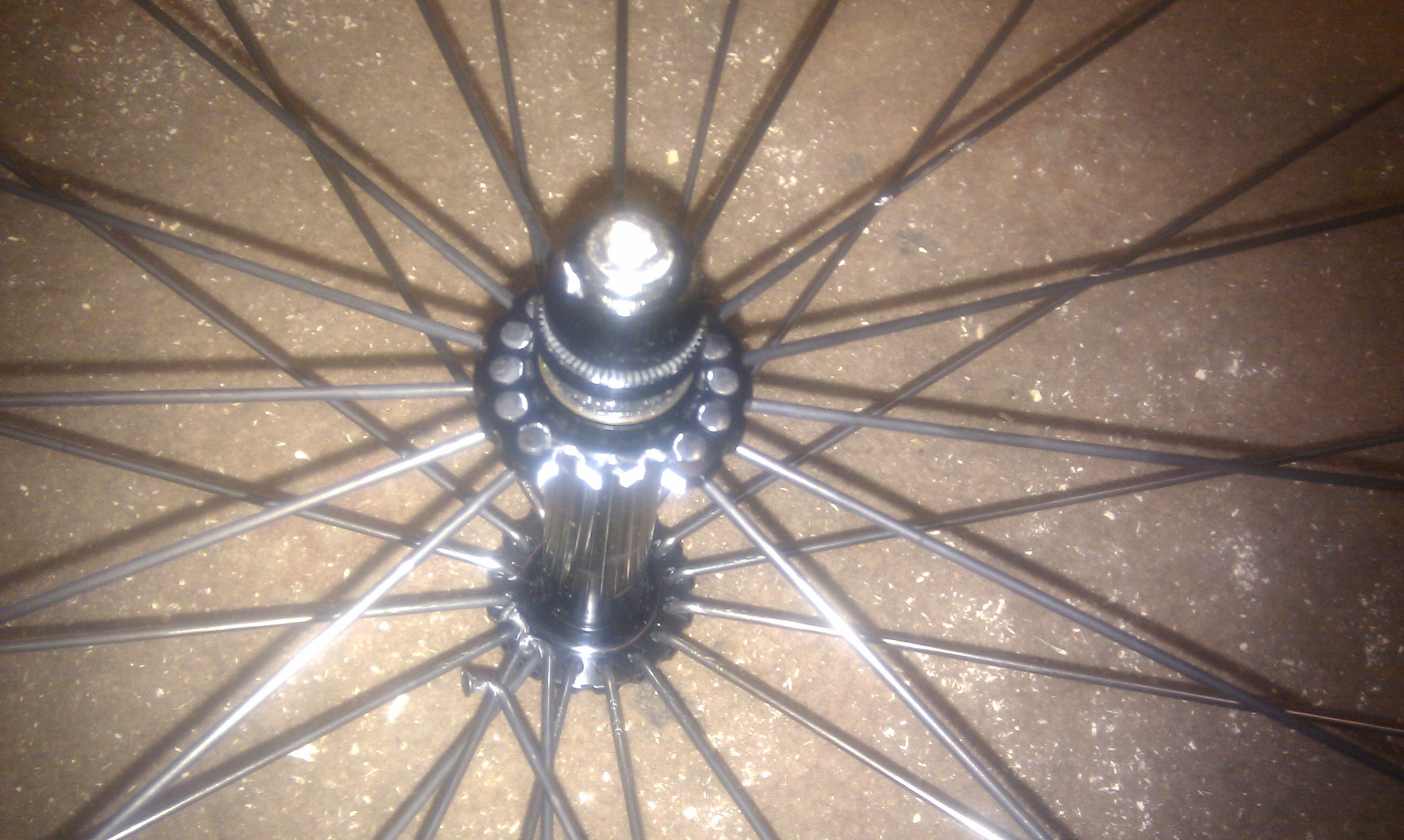

gary-mac Posted January 7, 2011 Report Share Posted January 7, 2011 (edited) After enjoying 2.5hours riding it was soon over after i sh*^t myself when a hugh bang came from the front wheel area wile doing a trackstand!!! It was loud and sounded serious, at first i thought it was the ti bolts on the hs33clamps as i have had a few fail when doing gap to fronts, i checked them and all was good, couldn't see in the dark so i just thought i'll cycle back to van then i realised the bike wouldn't move, closer look with the phone lite and there was the problem, the flange had serious failure and the wheel looked like it had been in a train crash!!!! buckled was a understatment. The wheel was a radial build which i'm now thinking is not such a good idea due to the sheer verticle forceput on the hub flange from the spokes, where as a cross lace pulls in 2ways which will spread the force on the hub. anyone else had this happing? Also it was -3 so would this of had something to do with the failure?? Lucky i have a spare wheel so i can still get out tis weekend. Edited January 7, 2011 by gary-mac Quote Link to comment Share on other sites More sharing options...

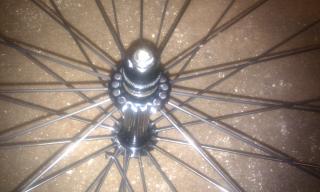

gage-mann Posted January 7, 2011 Report Share Posted January 7, 2011 Yea mine did this, it ripped 3 or 4 spokes out, i just lol'd and builded up the rim and spokes onto a hope hub i managed to get, but yea its a loud noise, did u make sure to loosen all the spokes off soo the rim want shaped funny/buckled? I had mine for about 4 or 5 months till it did it so i want arsed considering it was a really light hub. Quote Link to comment Share on other sites More sharing options...
ghostrider88 Posted January 7, 2011 Report Share Posted January 7, 2011 Overtightening the spokes when using radial lacing doesn´t pay off... Quote Link to comment Share on other sites More sharing options...

gage-mann Posted January 7, 2011 Report Share Posted January 7, 2011 Overtightening the spokes when using radial lacing doesn´t pay off... Mine were not tight but they were not loose, i made sure the wheel could flex more than usual because before i got the hub i did'nt think the flanges would be strong, i ran a vee brake and set the pads about 5mm from the rim each side so the pads would'nt touch when the wheel flexed, its just a lightweight, it want going to last for ever with flanges like that. Quote Link to comment Share on other sites More sharing options...
gary-mac Posted January 7, 2011 Author Report Share Posted January 7, 2011 (edited) Overtightening the spokes when using radial lacing doesn´t pay off... I didn't build the wheel so it's no my problem, If it gets sorted i'll get new spokes and build it crossed laced then i really don't see why there should ever be a problem after that. Edited January 7, 2011 by gary-mac Quote Link to comment Share on other sites More sharing options...

Matt Burrows Posted January 7, 2011 Report Share Posted January 7, 2011 Radial lacing puts a lot more stress on the hub. I'm surprised how many people use it now, the weight loss compared to a 2 or 3 cross lacing is minimal. Quote Link to comment Share on other sites More sharing options...

roboff Posted January 7, 2011 Report Share Posted January 7, 2011 This happened to my friends profile on his bmx, i thought it was funny how the spokes didnt break though. I assume radial lacing wont help either. Quote Link to comment Share on other sites More sharing options...
Matt Vandart Posted January 8, 2011 Report Share Posted January 8, 2011 Have you got anymore pictures? The design of the flanges is shite, for the weight saving it gives, what is the point? Quote Link to comment Share on other sites More sharing options...
