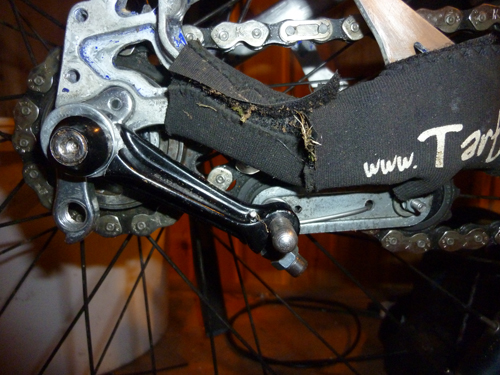

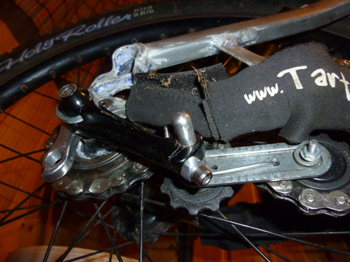

Matt Vandart Posted December 29, 2010 Report Share Posted December 29, 2010 I did this to make my chain tensioner even better. Bolt is 45mm titanium on one side and 35mm titanium on the other. Works mint, reduces weight and helps stop busting the hanger off...........because there isn't one. Sorry about the brothelesque pictures. Quote Link to comment Share on other sites More sharing options...

Miles Mallinson Posted December 29, 2010 Report Share Posted December 29, 2010 Cool, I 'am forever trying different was of tensioning my chain on my Effect, I did something similar but with a bit of old metal and a chainguide roller, them Ashton hangers are so bad aswell. Thats nicely tucked away. Quote Link to comment Share on other sites More sharing options...
Matt Vandart Posted December 30, 2010 Author Report Share Posted December 30, 2010 The best bit is the fixed arm is hard up against the dropout so hitting it wont matter a toss and the sprung bit is above the chainstay pretty much. Quote Link to comment Share on other sites More sharing options...
Miles Mallinson Posted December 30, 2010 Report Share Posted December 30, 2010 yeh that is a pretty good thing about ashtons that they have the dropouts up from the chainstay. Quote Link to comment Share on other sites More sharing options...
