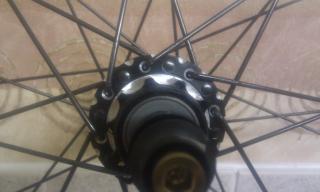

davey1991 Posted December 28, 2010 Report Share Posted December 28, 2010 Yer the differences in the picture and the real thing would make me worry, phone tartybikes asap if you can. I'm sure its probably ok but i wouldn't want to risk it. Quote Link to comment Share on other sites More sharing options...
gary-mac Posted December 28, 2010 Author Report Share Posted December 28, 2010 (edited) Purely the fact that it varies to the images on the Echo site is cause enough to question it; Yep i'll def phone tartys because as you have pointed out its perfect in the picture above and in my eyes the picture of my actual hub is wrong. As ali c has said also the sprockets he has fitted to the sl were snug with hardle any play!! This will be interesting when i call to find out, if adam could comment this would save me a phone call right enough Edited December 28, 2010 by gary-mac Quote Link to comment Share on other sites More sharing options...
cai Posted December 28, 2010 Report Share Posted December 28, 2010 The splines in that photo look spot on! Why arn't both of our's? Quote Link to comment Share on other sites More sharing options...

gary-mac Posted December 29, 2010 Author Report Share Posted December 29, 2010 (edited) Afternoon all, well i phoned tartys and am sure it was stan i got so explained the situation etc and emailed pictures through aswell so awaiting a return email, the funny thing was he went and got a sl hub to look at and guess what, it had nice flat machined teeth which sounds to me i have a faulty echo hub. how cheesed off i'll be if this is the case!!! Edited December 29, 2010 by gary-mac Quote Link to comment Share on other sites More sharing options...
AdamR28 Posted December 29, 2010 Report Share Posted December 29, 2010 The shape of the splines on the hub could be that way to try and stop the cog digging in too much. RB had a similar design on their hubs many years ago. In terms of strength the triangular shape of these splines is fine I have a goldtech hub with the same kind of setup Echo often make rolling changes (such as the axle bolt washers which are different on the hub you have to the ones in the photos). I've emailed Echo to see what they say, but I can't see a problem using the hub like it is. Quote Link to comment Share on other sites More sharing options...
gary-mac Posted December 29, 2010 Author Report Share Posted December 29, 2010 Echo often make rolling changes (such as the axle bolt washers which are different on the hub you have to the ones in the photos). I've emailed Echo to see what they say, but I can't see a problem using the hub like it is. Well lets see what echo have to say, Am 100% this aint right but i could be wrong, If the hub stan was looking at today was perfect why is the new one i have not the same, very odd!! i'd far rather have one thats fits the sprocket correctly, If you have a look at your sl hubs and see if you can find one with shark teeth profile and try the sprocket on, Its feels pretty shocking how loose it is. Quote Link to comment Share on other sites More sharing options...
gary-mac Posted December 29, 2010 Author Report Share Posted December 29, 2010 Well well well thanks to Adam at tartys for emailing echo with my pictures because the hub I have is faulty and no ware near correct so its getting changed through warranty. Pretty happy I started this thread as I would of went ahead and just used it. Down side is my wheel build was pointless as I now have to de-lace and start again with a new hub. So how many more are there out there with the same problem? Quote Link to comment Share on other sites More sharing options...
Matt Burrows Posted December 29, 2010 Report Share Posted December 29, 2010 As Adam, Matt Vandart and myself suggested it's not really an issue. The shape of the splines will help to stop the cog digging in. I imagine a lot of people would just run the hub and never have a problem with it. Quote Link to comment Share on other sites More sharing options...
gary-mac Posted December 29, 2010 Author Report Share Posted December 29, 2010 As Adam, Matt Vandart and myself suggested it's not really an issue. The shape of the splines will help to stop the cog digging in. I imagine a lot of people would just run the hub and never have a problem with it. yeah true am sure there are alot of people out there who would just use it but for me it aint right and i like things to be the way they are ment to be. lets face it, the hub is faulty, if you guys could see how bad the fit is you would undrstand, apart from moving back and forth it also moves up and down about 2mm there for not catching the teeth alot at all. DODGY.COM. Quote Link to comment Share on other sites More sharing options...

gary-mac Posted January 4, 2011 Author Report Share Posted January 4, 2011 update on echo sl hub. Phoned up tarty bikes this morning and all is well, sure it was adam i was talking too, problem solved so theres a nice shiney new hub on its way to me with no machine faults all checked by the man himself. was very helpful so thanks again. I've now de-laced the wheel and the faulty hub is packed up ready for sending back. While i was at it i used my christmas vouchers and bit the bullet, with some advice from adam i've got the rockman carbon bars on the way with echo tr 2011 pedals and 2x white try-all grips. once i have the new hub i will post some pictures of the hub splines plus with the sprocket fitted. Quote Link to comment Share on other sites More sharing options...

gary-mac Posted January 7, 2011 Author Report Share Posted January 7, 2011 Hi guys, well heres the wheel all built up with a perfect echo sl hub!! sprocket fits a treat, really tight fit the way it should be. now to go fit it and use it!! Quote Link to comment Share on other sites More sharing options...
monkeyseemonkeydo Posted January 8, 2011 Report Share Posted January 8, 2011 That looks more like it! Quote Link to comment Share on other sites More sharing options...
gary-mac Posted January 8, 2011 Author Report Share Posted January 8, 2011 That looks more like it! yeah dam right it is!! just fitted the wheels and all is well ). Quote Link to comment Share on other sites More sharing options...
