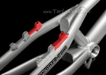

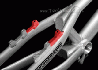

Azarathal Posted December 30, 2010 Report Share Posted December 30, 2010 I don't know if this has been said but i'll give it a go anyway. In regards to Onza1's suggestion, could you not have 19" vee mounts and stupidly long vee arms with tonnes of adjustment? I know it'd flex like a bitch but it'd help newbies out instead of being stuck with a 20" rear until they save up enough to upgrade. Another option for the vee is have 2 vee post positions that you can screw posts into? Also something like this could be done for maggys. (I've made the 20" mounts red just to make the addition that little bit more obvious) Quote Link to comment Share on other sites More sharing options...
AdamR28 Posted December 30, 2010 Report Share Posted December 30, 2010 Was ditched a few years ago... http://users.aber.ac.uk/sjs99/bike/kit/onza_first_look.htm Quote Link to comment Share on other sites More sharing options...
Azarathal Posted December 30, 2010 Report Share Posted December 30, 2010 Ah ok, was worth a shot :3 Quote Link to comment Share on other sites More sharing options...
Scott Gibbs Posted December 30, 2010 Report Share Posted December 30, 2010 Was ditched a few years ago... http://users.aber.ac.uk/sjs99/bike/kit/onza_first_look.htm I remember them it was so you could run 24" wheels on that frame. Quote Link to comment Share on other sites More sharing options...
MK999 Posted December 30, 2010 Report Share Posted December 30, 2010 It also wouldnt work with 19-20", as the 2nd set of bolts would have to start in the middle of first set (inch, 25.4mm/2=12.7mm) Unless you start getting into (more flexible) adapters and costs starts going up etc etc Quote Link to comment Share on other sites More sharing options...

Dan Clark Posted January 1, 2011 Report Share Posted January 1, 2011 Instead of all these ridiculous adapter ideas, couldn't Onza just put a second set of lug mounts 1/2" lower than the current ones, then when you want to upgrade, unscrew your current lugs, move them to the lower mounts, voilá. Quote Link to comment Share on other sites More sharing options...
wip-bikes Posted January 1, 2011 Report Share Posted January 1, 2011 I think they used to on the old T Rex and Raptors, wasn't great though. Quote Link to comment Share on other sites More sharing options...
isitafox Posted January 1, 2011 Report Share Posted January 1, 2011 Instead of all these ridiculous adapter ideas, couldn't Onza just put a second set of lug mounts 1/2" lower than the current ones, then when you want to upgrade, unscrew your current lugs, move them to the lower mounts, voilá. Or stick a disc mount on, that surely couldn't make the frame much more expensive to make?! Quote Link to comment Share on other sites More sharing options...
