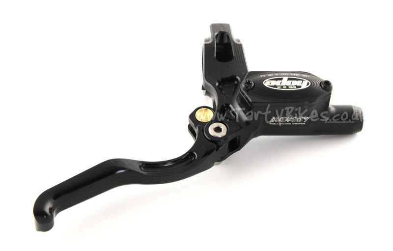

Sponge Posted December 20, 2010 Report Share Posted December 20, 2010 I just went out to buy a set of torx keys to remove the reservoir cap from my bro's Hope Mono Trial. It was originally bought second hand so the little T10 torx bolts were already a little worse for the wear. No luck getting the 2 bolts out with the T10 torx key I got, so I'm wondering what solutions there are? Last resort I might try the superglue method, but not even sure if that's strong enough to get the little bolts out? Seems the previous owner hamfistedly tightened them in... argh I'm pretty sure at least a small handful of people must've done this at some point, so if you could share some solutions that'd be great! Thanks Quote Link to comment Share on other sites More sharing options...

Sponge Posted December 21, 2010 Author Report Share Posted December 21, 2010 The bolts are domeheaded and very very small, but also very hard so it's hard to cut a line in them with a hacksaw. The file either side method could work but because of the way they mount on the Hope reservoir cap, it's not really a viable option without trashing the cap. I've borrowed a pic from Tartybikes to clarify exactly what I mean: The two little bolts either side of the Hope logo. I'm considering getting either industrial strength epoxy resin or a pro-grabit screw remover. Quote Link to comment Share on other sites More sharing options...
