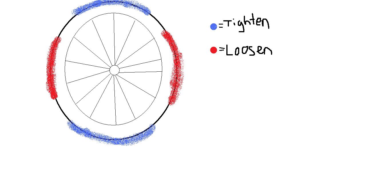

ginger allen echo Posted December 12, 2010 Report Share Posted December 12, 2010 it's egged then, Try tightening the spokes where the egged parts of the rim are to pull them in so it's more rounded. If that make sense? Quote Link to comment Share on other sites More sharing options...

Azarathal Posted December 13, 2010 Report Share Posted December 13, 2010 Loosen every spoke off until you see a tiny bit of thread and then go around giving each spoke 1turn each until you get complete tension. After 6-7 turns some spokes will be hard to turn while some will be easy. Don't skip any. If they all have the same amount of turns then the wheel should end up relatively true without needing much fine tuning. Quote Link to comment Share on other sites More sharing options...

Luke Rainbird Posted December 13, 2010 Report Share Posted December 13, 2010 Loosen every spoke off until you see a tiny bit of thread and then go around giving each spoke 1turn each until you get complete tension. After 6-7 turns some spokes will be hard to turn while some will be easy. Don't skip any. If they all have the same amount of turns then the wheel should end up relatively true without needing much fine tuning. Not really true once the rim or spokes have taken abuse. If the wheel was badly buckled as you say, then it'll keep screwing itself/you over and is probably time to replace the parts. If it lasts long enough for a ride or two then stick with it a while, and take a spoke key with you. Keep an eye on it and if it's too much hassle you know a new rim is in order Quote Link to comment Share on other sites More sharing options...
