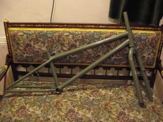

zoster Posted December 7, 2010 Report Share Posted December 7, 2010 (edited) EDIT: CURRENT BUILD ( V4): changes: went back to 25.4 handlebars, because i realized i like the elasticity (i won't like the face plant as much, but hopefully that won't happen without notice) went ffw again, i realised i REALLY missed the weight distribution. running 17/12 now which feels great for street-trials (similar to 22/16) lost the brake booster and i can't say i notice any difference lost the front brake and i really enjoy it like this. i rode brakeless a few months before building this setup and i missed the smoothness and the simplicity so i went halfway and kept the rear brake only which i tend to use as little as possible got the echo fork back on (it's a bit shorter and i like the geo better, plus marino's fork was is a bit asymmetric which bugs me) put on a kenda k-rad on the back as well and i love it. holds well enough for trials and it feels great at street stuff and cruising around also changed my previous grips (which were slim lock-ons with an outer layer of tennis grip) with trialtech foam ones. it's cool they're so light, and they are actually tough, which is surprising, they also stay put, which also is also surprising, but they do feel a bit more "fluid", yet not enough to be annoying, so it's all good... that's about it. i think i'll keep this setup for a while since i really enjoy it feel free to comment the tensioner works well nice so far EDIT: PREVIOUS BUILD (V2) changed some drive train stuff and handlebar/stem. have the 23T trialtech sprocket and a bashring i locally build for around 12gbp. bashring is 84g, 6mm wide, 110 exterior diameter so that it can adopt a 24t sprocket in case some manufacturer decides to build them. chain tension is so far ok, but will loosen soon enough. i'll probably try a spoke tensioner first. didn't get a chance to ride it since it snowed. will have to see if i get along with front vees this time around... INITIAL POST: right, so here are the first pics of my upcoming build. if everything goes well, tomorrow i'll have a fully functional bike. here's what i asked for: (the wrapping shape of the spoke was his input, i'll go with the "laid" shape (paint is done locally) Edited May 17, 2011 by zoster Quote Link to comment Share on other sites More sharing options...
Jon Alty Posted December 7, 2010 Report Share Posted December 7, 2010 (edited) chainstay looks stupidly thin no? I dont know much about BMXs though so :\ Edited December 7, 2010 by Jon Alty Quote Link to comment Share on other sites More sharing options...
zoster Posted December 7, 2010 Author Report Share Posted December 7, 2010 chainstay looks stupidly thin no? I dont know much about BMXs though so :\ bmxs? was that sarcasm? Quote Link to comment Share on other sites More sharing options...
ogre Posted December 7, 2010 Report Share Posted December 7, 2010 chainstay looks stupidly thin no? its steel, doesn't need to be as large diameter tubes to be as strong as allow. looks nice! whats the perk of the vee mounts underneath? Quote Link to comment Share on other sites More sharing options...
Ross McArthur Posted December 7, 2010 Report Share Posted December 7, 2010 NICE!! I like the spoke bitty. Not so much a fan of the colour but the geo sounds quite nice. Maybe some stickers on it would break up the colour a bit? Quote Link to comment Share on other sites More sharing options...

eskimo Posted December 8, 2010 Report Share Posted December 8, 2010 (edited) Mega short rear end? Looks pretty compact. Not fan of the colour but am interested to see when finished. [edit] Should of looked at the first pic. 378mm. Looked a bit shorter. Though the wheelbase is short! Edited December 8, 2010 by eskimo Quote Link to comment Share on other sites More sharing options...
Ross McArthur Posted December 8, 2010 Report Share Posted December 8, 2010 Shorter the better (backend) Quote Link to comment Share on other sites More sharing options...
