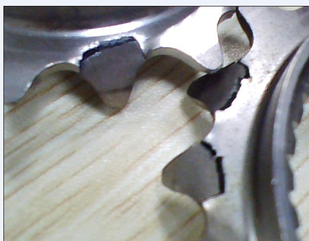

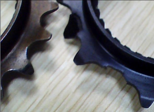

Mark W Posted December 7, 2010 Report Share Posted December 7, 2010 someone from supercycles who told me How nice of them. That batch didn't make it out of the factory so I can't really see how you would've got one of them, unless that was the one from Neil, perhaps? We got sent some photos of some freewheels that went through Echo's QC tests and they'd deformed/warped like they were made out of plasticine or something. No heat treatment = no good. FWIW, all the 96 click freewheels I've had have been fine for a few months, but then started skipping. Because of how fine the ratchet mechanism is on those freewheels, and because of the shape of the pawls being more rounded than other high-engagement freewheels are, it seems like once they've skipped a few times and the pawls get a little worn they just start to do it more and more. Same story as the Eno in many ways - you can get spares for the Eno/Tensile, and you'll most likely need them. There aren't spares available for the TRs/SLs, but it's most likely you won't ever need them. It's pretty weird how your's broke to that extent though, 'cos like I said it's not something I've seen in the past year I've been at TartyBikes. I've literally never seen a freewheel as consistent and durable as Ali's SL was (and still is), and mine, Stan and Adams have been faultless. Same goes for pretty much all the known freewheel killers we've sold them too. There's one guy in particular on OTN who used to plough through other freewheels really quickly but bought an SL on Adam's recommendation and hasn't managed to kill it yet. Quote Link to comment Share on other sites More sharing options...
AdamR28 Posted December 7, 2010 Report Share Posted December 7, 2010 How nice of them. That batch didn't make it out of the factory Indeed. And I’ve got pictures of freewheels, this is done by another factory as well. They have missed out the thermal treatment procedure, and you can see the color is abnormal. I have done some rigidity tests, the report looks terrible! We are now making everything ourselves, cannot take the risk anymore!!! Our workers are taking 2 shifts and machines are on 24 hours. Quote Link to comment Share on other sites More sharing options...
Mark W Posted December 7, 2010 Report Share Posted December 7, 2010 ...and while we're on that particular subject, just to clarify it - none of those freewheels made it onto the UK market (unless they were bought direct from overseas by a customer) because we didn't receive any of the many freewheels we'd ordered that were due to arrive from that batch because they failed those checks, hence us being out of stock of TRs and SLs for what felt like eternity. Quote Link to comment Share on other sites More sharing options...
