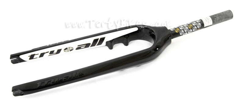

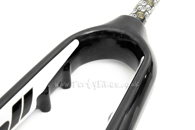

One thing for people to know when they get that fork. The insert's threads on the Magura mounts are not cleaned up so when you want to tighten the brake clamps, it locks up without tightening the clamps. Only way to achieve correct tightening is to clean the insert's threads with some tools you use to make the threads (I don't know how it's called sorry):
I think it's sad that Koxx didn't make it straight when they produced the fork but whatever it's a very nice composite product!!! I am glad Tartybikes sells them!

They're called taps :)

Fitted a set for Jack Carthy, no problems at all with the brake mounts. As with any 4-bolt fork though, never a bad idea to chase them through if you are concerned :)
Good news! Maybe we had a bad set then... We got it directly from the study desk of K-124. Anyway, I think it's a shame for them not to mke a disc version.
Probably because you used grease! It's good stuff you know
We didn't at first, but then we did, it changed nothing.
