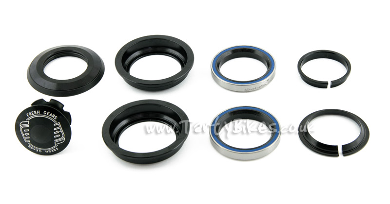

So I was test fitting the parts I bought and have worked out the easy stuff (like where the bearings go and such) but the headset came with 3 shims that arn't pictured on tarty.
http://www.tartybikes.co.uk/images/headsets/large_atomz2.jpg
So what are they for and more importantly where do they go? they look like the ones pictured on the hope headset
http://www.tartybikes.co.uk/product.php?product_id=10147&category_id=88
so do they serve the same purpose?
