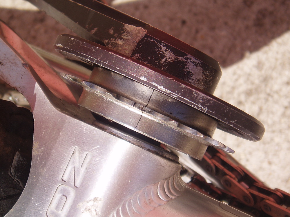

monty221ti Posted November 6, 2010 Report Share Posted November 6, 2010 http://www.facebook.com/?ref=home#!/photo.php?fbid=1685785589116&set=a.1399313907503.2056582.1371935053 my echo sl freewheel broke tobay, it cracked on the other ring where the theeth´s are, it cracked all the way. Anyone tried this brefore? the freewheel was in very good condition. never opened and it was good lubricated:) Sorry for the bad english. Quote Link to comment Share on other sites More sharing options...

Rusevelt Posted November 6, 2010 Report Share Posted November 6, 2010 If you can reload the photo on your facebook, i'm pretty sure everyone here would be curious to see how you managed to break the outer shell of your Echo SL freewheel under normal riding use. I eventually broke mine after 3-4 months of use as the result of freak accident from a hard impact, so it wouldn't be a fair comparison really. Quote Link to comment Share on other sites More sharing options...

craigjames Posted November 6, 2010 Report Share Posted November 6, 2010 Could you get an actual photo of the crack as that just looks like you've put a line on the Tarty bikes pic using Microsoft paint.... Quote Link to comment Share on other sites More sharing options...

monty221ti Posted November 6, 2010 Author Report Share Posted November 6, 2010 If you can reload the photo on your facebook, i'm pretty sure everyone here would be curious to see how you managed to break the outer shell of your Echo SL freewheel under normal riding use. I eventually broke mine after 3-4 months of use as the result of freak accident from a hard impact, so it wouldn't be a fair comparison really. it´s the same crack as this one, mine is just between two theet. Maybe there was a fail in mine? and yes i´ve made the picture in paint to illustrate the crack:D Quote Link to comment Share on other sites More sharing options...
monty221ti Posted November 6, 2010 Author Report Share Posted November 6, 2010 Could you get an actual photo of the crack as that just looks like you've put a line on the Tarty bikes pic using Microsoft paint.... i did, can´t realy get a good photo pf the crack with my cam. but it's the same type of crack as RUSEVELT posted here, my FW was just 100% in order, no dents or broken theet, the lockring was also kept tight, but it's came loose often.also, what can i do so my FW dont crack, if theres eny solusion? keep the lockring tight, if there any solusion that can make the lockring tight constantly? as i cant weld it because it's steel - titanium? Quote Link to comment Share on other sites More sharing options...
