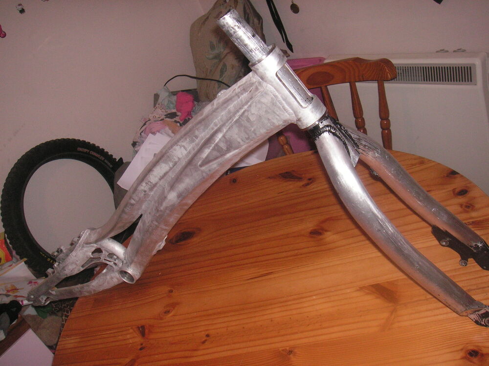

Balls Deep trials team Posted October 31, 2010 Report Share Posted October 31, 2010 (edited) hi i have an onza 320 thats been painted black .. obv im gonna use nitromors to strip the paint off to get it back to the gold . but how can i get the gold anodising off ? iv used oven pride to remove anodising on parts before but obv the frame is to big to fit in the bag do u recon i could just brush it on and just rinse with water ? or is there another way with out getting it sand/bead blasted? sorry theres been a few of these topics latly but iv look at the others and found no answer .. cheers Edited November 1, 2010 by Balls Deep trials team Quote Link to comment Share on other sites More sharing options...

Ali C Posted October 31, 2010 Report Share Posted October 31, 2010 just get caustic soda, available from most hardwear stors (B&Q for example). Add to hot water, use a toothbrush or something to apply to the frame and watch the magic happen. I found Caustic soda to be far more efficient than oven cleaner, you can make the solution stronger and as I said above, adding to hot water really makes the reaction happen! Quote Link to comment Share on other sites More sharing options...

Balls Deep trials team Posted November 1, 2010 Author Report Share Posted November 1, 2010 got some caustic soda today gonna give it a go and i dnt want the frame to be shiney just want to keep the grainy affect it has with the gold cheers for the help Quote Link to comment Share on other sites More sharing options...

craigjames Posted November 1, 2010 Report Share Posted November 1, 2010 Yes, indeed it is. It's abrasive enough to remove general oxidisation but not a decent layer of anodizing easily. Where as caustic soda will do the job easy peasy. Quote Link to comment Share on other sites More sharing options...

Balls Deep trials team Posted November 1, 2010 Author Report Share Posted November 1, 2010 what it looks like after the caustic soda Quote Link to comment Share on other sites More sharing options...
craigjames Posted November 1, 2010 Report Share Posted November 1, 2010 looks pretty good get some scotch bright and give it a good rubbing over to clean it up and that'll look mint Quote Link to comment Share on other sites More sharing options...
