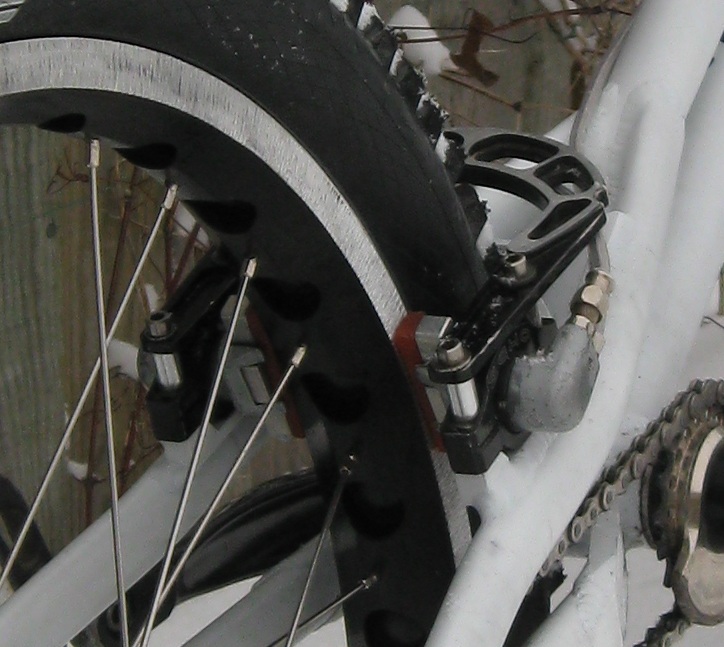

Phatmike Posted December 19, 2010 Author Report Share Posted December 19, 2010 I'm liking Joe's setup - looks sweet. I'll throw mine into the mix: Josh & I spent a night in his workshop the other week re-welding and adding a plate onto the chainstays and modifying the brake mounts. We aligned the frame and milled out each mount, hand finishing each one with an angle grinder. It's loads cleaner and much stiffer than with both halves of the mount. Next step is to mount the booster on top of the mount as the booster sits below the centre of the piston, so the mounts still flex outwards. On top of the mounts should see it in line with the centre, so maximum power captain! Quote Link to comment Share on other sites More sharing options...
casualjoe Posted December 20, 2010 Report Share Posted December 20, 2010 You definitely win 'Slimfast slimmer of the week' Mike. Excellent idea though, this should be the standard 4-bolt mount fitment, it seems like it puts way less stress on the bolts with the cylinder supported directly by the frame. And Si, that splitter I bought off here was utter dogshite haha. Quote Link to comment Share on other sites More sharing options...

SamKidney Posted December 20, 2010 Report Share Posted December 20, 2010 Surely having the cylinder directly mounted to the frame would mean your wheel would have to be exactly in the right place? This set up wouldnt work on a mod due to the horizontal dropouts, where you need the fore and aft adjustablity with different chain lengths ect. . Would only work on stocks with vertical dropouts where the wheel is in a constant place. The only Mod I can think of that would work with this set up would be the Atomz Premier 20 with its vertical drop outs. Really good Idea though Mike, that I think should be employed on Stock frames with vertical dropouts Quote Link to comment Share on other sites More sharing options...
dann2707 Posted December 20, 2010 Report Share Posted December 20, 2010 If you had this on a mod though, and were feeling uber bodgy, you could set up the wheel in line with the brakes and make a spoke tensioner. Think it looks pretty decent though Quote Link to comment Share on other sites More sharing options...
