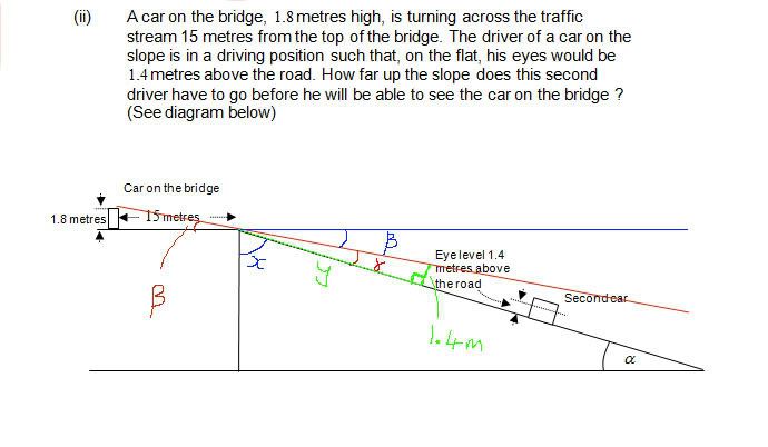

dann2707 Posted October 21, 2010 Report Share Posted October 21, 2010 (edited) Hey. Got this last question that's bugging the hella out of me. If anyone who's good at maths can throw me in the right direction I would seriously appreciate it. I've managed part i) ii) is the one giving me problems. Cheers in advance! Edited October 21, 2010 by dann2707 Quote Link to comment Share on other sites More sharing options...
AdamR28 Posted October 21, 2010 Report Share Posted October 21, 2010 Draw yourself another diagram for part 2, at the point where car 2 just starts to see car 1, you can then work out the angles and distances 1 Quote Link to comment Share on other sites More sharing options...
Tomm Posted October 21, 2010 Report Share Posted October 21, 2010 Spoiler alert: http://img.photobucket.com/albums/v427/tomnelson/index-2.jpg OK, start off looking at the red line. The angle between the top of the car on bridge and the crest of the road. You know it's 15m and 1.8m so you can calculate beta. Blue line: I've extended the horizontal of the bridge - the angle between this and the red line is also beta (opposite angle thing). Work out x (=180 - alpha - 90) x + beta + gamma = 90 degrees. You know x and beta so you can calculate gamma. Then finally the green bit - you can create yet another triangle that will be created when the driver coming up the slope reaches the point where he can just see the top of the other car. This triangle is bordered by the red line, green line(y) and the height of the driver's eyes (1.4m), with an angle of 90degrees from the slope of the incline. With gamma and the height (1.4m), you can calculate y. But you need to know how far UP the slope the car needs to go, so your answer is 50 - y EDIT: beaten 1 Quote Link to comment Share on other sites More sharing options...
dann2707 Posted October 21, 2010 Author Report Share Posted October 21, 2010 (edited) Thanks a lot for the answers! Very helpful indeed especially the diagram. I managed to get 38.41m up the slope for the final answer. Cheers again. Edited October 21, 2010 by dann2707 Quote Link to comment Share on other sites More sharing options...
