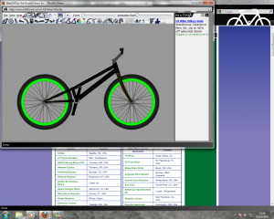

dirt jumper jake Posted October 16, 2010 Report Share Posted October 16, 2010 Hi all, been looking on ther interwebs and came across this: http://bikeforest.com/CAD/# Basically you can make your own geo bike if you take your time. thought some people might be interested on here as there have been a few custom geo frames made on here. i made one after about 20 mins so if you took your time you could probably use this to design a frame geo how you want it and send it to marino or do it yourself. enjoy. Quote Link to comment Share on other sites More sharing options...

matt.price Posted October 16, 2010 Report Share Posted October 16, 2010 looks good . put how did you get it for a trials bike? or do i just have to take the seat off? Quote Link to comment Share on other sites More sharing options...
Ben Cox Posted October 16, 2010 Report Share Posted October 16, 2010 lol wicked, havent played with this in years (since it was last posted on here). run a search and you'll probs find some other folks bikes . Ben Quote Link to comment Share on other sites More sharing options...
dirt jumper jake Posted October 16, 2010 Author Report Share Posted October 16, 2010 looks good . put how did you get it for a trials bike? or do i just have to take the seat off? yeah take the seat off and literally f**k around with the geo till it looks like one haha Quote Link to comment Share on other sites More sharing options...

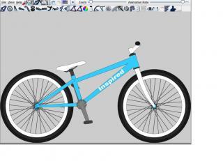

Greetings Posted October 16, 2010 Report Share Posted October 16, 2010 The Handlebar from BB measurement is a bit odd, I think it measures it in one dimension. If you put 680 for a stock you get a 1150+ wheelbase. I'm on about the measurements which you can display on the bike itself, as below: I'll be ordering a custom frame in 1-2 months so this program is ideal to settle on the head angle and reach. Unfortunately without those two measurements it's completely useless. Quote Link to comment Share on other sites More sharing options...
Mark W Posted October 16, 2010 Report Share Posted October 16, 2010 Do you just mean in terms of getting the HA on the image too? Regarding the WB you got off that, what HA did you put on it? That'll have a pretty big impact on things... Quote Link to comment Share on other sites More sharing options...
Greetings Posted October 16, 2010 Report Share Posted October 16, 2010 Do you just mean in terms of getting the HA on the image too? Regarding the WB you got off that, what HA did you put on it? That'll have a pretty big impact on things... The head angle is already on the image, it's on the front tyre. I'm biased between 72, 72.5 and 73 HA and would like around 670-680mm reach with a 45-55mm BB rise. I'm wondering what the wheelbase will be with such settings. However you cannot set the reach in this program and it won't display the wheelbase because the wheelbase field is blanked out. Quote Link to comment Share on other sites More sharing options...
Mark W Posted October 16, 2010 Report Share Posted October 16, 2010 The front-centre dimension is reach? Quote Link to comment Share on other sites More sharing options...
Luke Rainbird Posted October 16, 2010 Report Share Posted October 16, 2010 The front-centre dimension is reach? Nope, that'll be BB to front axle from what I can recall. I think there's the option to put the reach in in terms of x&y, rather than an individual distance, though that may include the stem on BikeCAD if my memory serves me right. Throw the wheelbase in using Front-Centre (chainstays + front-centre will be within a mm or two of the wheelbase) then get it to display enough that you can calculate reach - pain in the arse yes, but it works Edit; That'd be around 1095, 380, +35, 71.5. Reach of around 685/690mm. Enough info on there for you to work out what you want, to a reasonable level of accuracy at least Pretty handy when ordering from Marino as mentioned - it's so much nicer to be able to give a detailed picture than try to explain every last detail to the poor chap via email (though I did that too!) Quote Link to comment Share on other sites More sharing options...

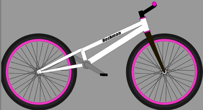

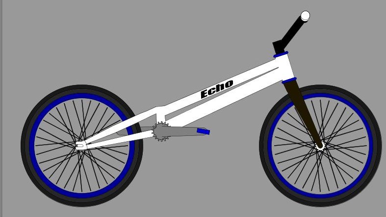

Rockman Posted October 17, 2010 Report Share Posted October 17, 2010 The bikes I made on bikeCAD. Quote Link to comment Share on other sites More sharing options...

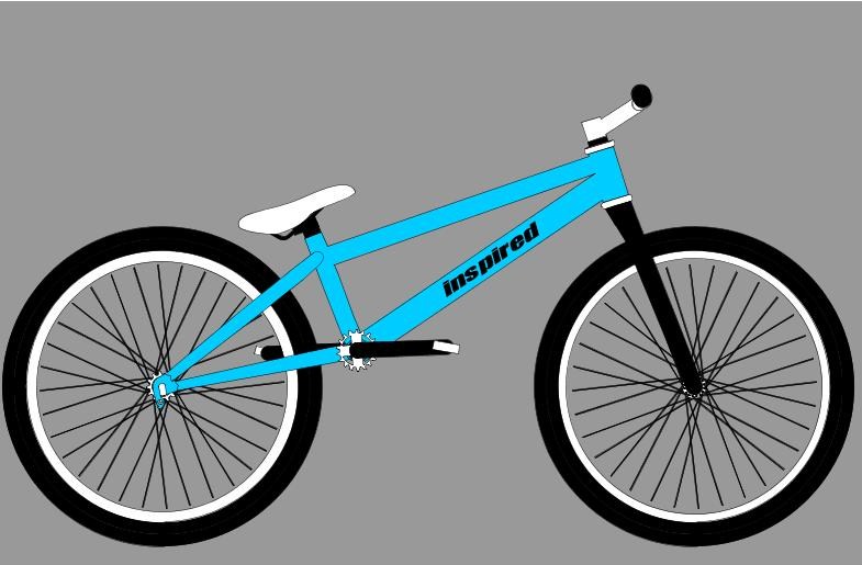

bikeperson45 Posted October 17, 2010 Report Share Posted October 17, 2010 (edited) Is this, or is it not, the perfect 26"? Let's face it, I pretty much designed the Hex Edited October 17, 2010 by bikeperson45 Quote Link to comment Share on other sites More sharing options...
