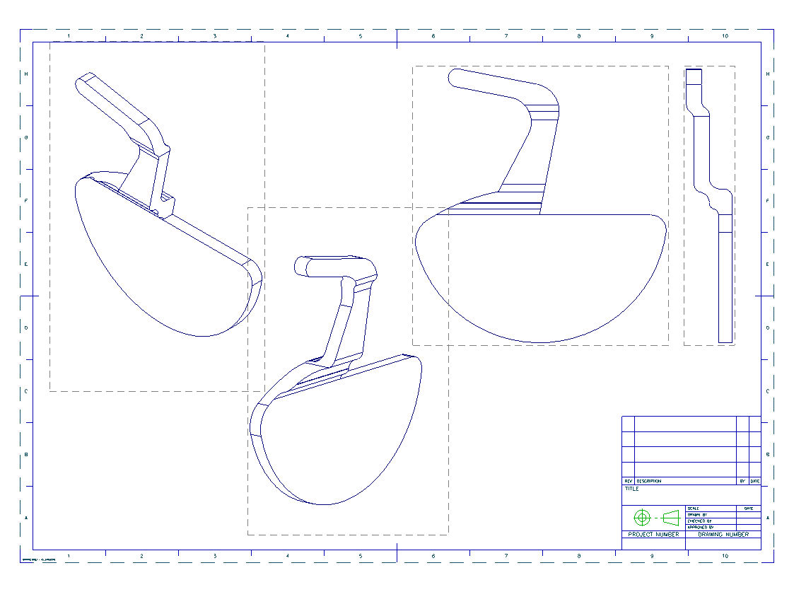

krazykid009 Posted September 26, 2010 Report Share Posted September 26, 2010 Had a go at doing a quick design for one that would maybe go onto the axle before the axle nut, but it is limited to the rear only. Oh well, here it is: Would it work? James Quote Link to comment Share on other sites More sharing options...
AlexxRogers Posted September 26, 2010 Author Report Share Posted September 26, 2010 Had a go at doing a quick design for one that would maybe go onto the axle before the axle nut, but it is limited to the rear only. Oh well, here it is: Would it work? James That could definitely work, problem now is snail cams, most frames run them on the inside, and you wouldn't be able to run one on the left side, that's why I was thinking about bolting on with the caliper. Quote Link to comment Share on other sites More sharing options...
krazykid009 Posted September 26, 2010 Report Share Posted September 26, 2010 That could definitely work, problem now is snail cams, most frames run them on the inside, and you wouldn't be able to run one on the left side, that's why I was thinking about bolting on with the caliper. I meant t to go on the outside of the frame. I was looking at the new Onza Pro on Tarty when I designed it so did it on that. Will see if i can do something to the design to change it to bolt onto the caliper James Quote Link to comment Share on other sites More sharing options...
AlexxRogers Posted September 26, 2010 Author Report Share Posted September 26, 2010 I meant t to go on the outside of the frame. I was looking at the new Onza Pro on Tarty when I designed it so did it on that. Will see if i can do something to the design to change it to bolt onto the caliper James Ahh right, wouldn't work on my Echo though It's nice having options though. Thanks for your input. Quote Link to comment Share on other sites More sharing options...

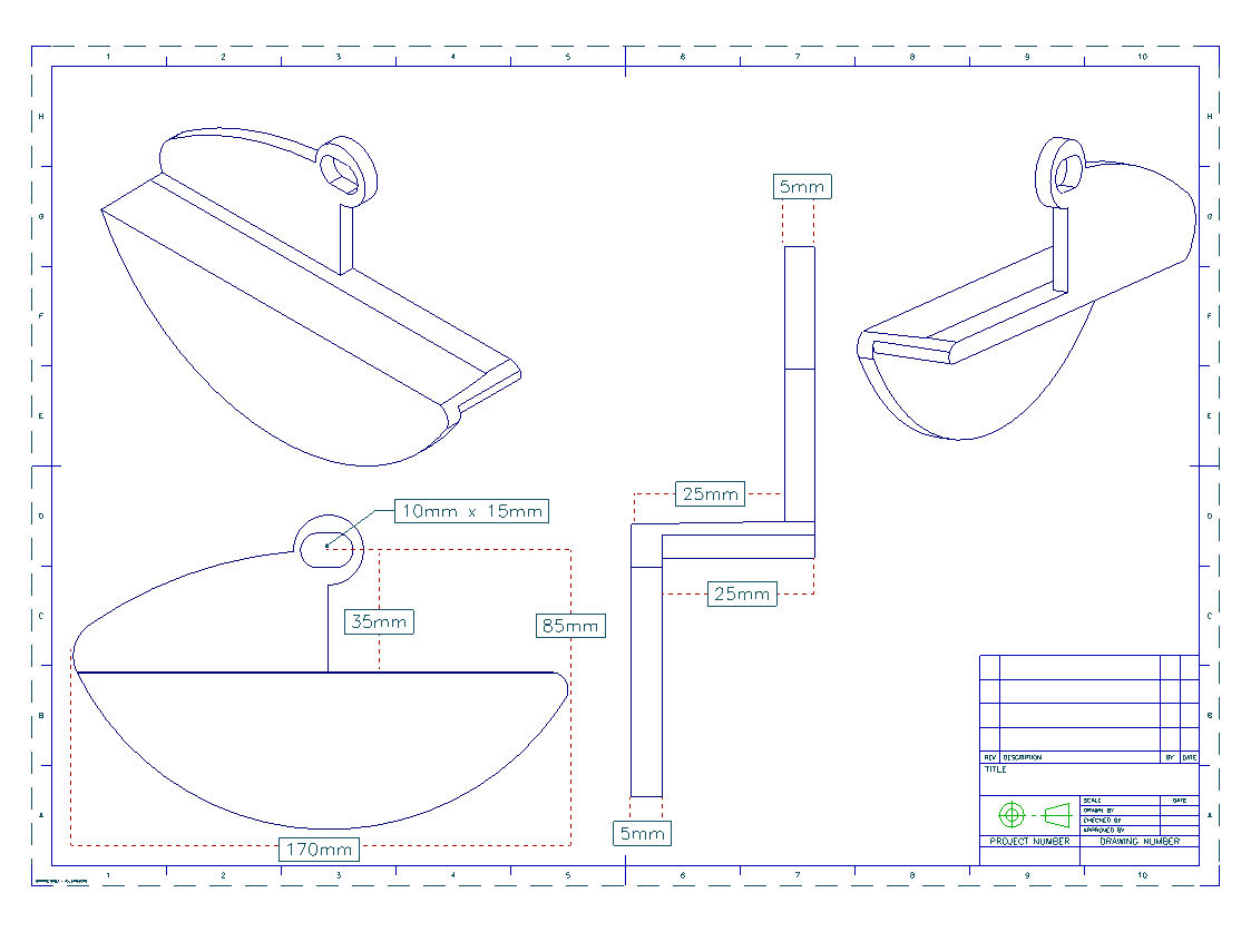

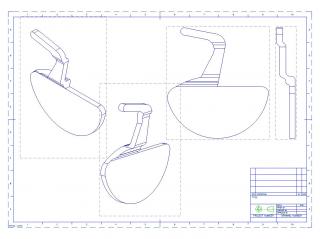

krazykid009 Posted September 26, 2010 Report Share Posted September 26, 2010 (edited) How about this sort of thing. Maybe it's manufacturable if you could fnd the right stuff, but as to how it would hold up the arm does look pretty thin There would be holes in the top arm that fit the disk mount, you would just need longer bolts as it would go through basguard->Disk tab->Caliper James Edited September 26, 2010 by krazykid009 Quote Link to comment Share on other sites More sharing options...
AlexxRogers Posted September 26, 2010 Author Report Share Posted September 26, 2010 How about this sort of thing. Maybe it's manufacturable if you could fnd the right stuff, but as to how it would hold up the arm does look pretty thin There would be holes in the top arm that fit the disk mount, you would just need longer bolts as it would go through basguard->Disk tab->Caliper James That's much better dude, I could work off that tweaking the design, to make it stronger, and lighter, if you don't mind me using it? Thanks James, big help dude! Alex. Quote Link to comment Share on other sites More sharing options...
