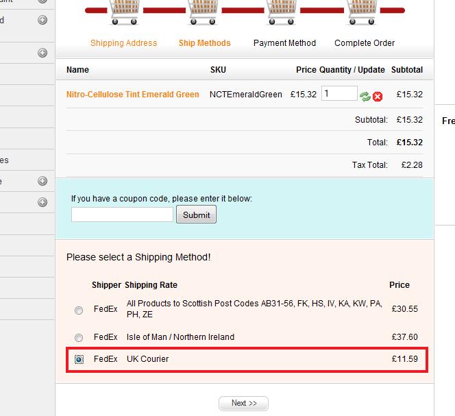

Skoze Posted September 26, 2010 Report Share Posted September 26, 2010 Definitely a good call, could look sweet! Have no idea what caused it, but there was some pretty funky patterns around the headtube on the Bump that looked awesome under the coating - same with the brazes, they looked turquoise most of the time which was rad. Bloody hell that's pricey, shirley it can't weight hat much!? Quote Link to comment Share on other sites More sharing options...
Mark W Posted September 26, 2010 Author Report Share Posted September 26, 2010 I'd imagine it's for "Not exploding in a mailbag" sort of purposes. If they packed them well it wouldn't really be an issue in that it's usually a 2kg limit for 'normal' 1st class, and one can of 400ml of lacquer shouldn't really weigh that much incl. packaging. Still, that's life I guess. Sure as shit aren't buying that any more though! Quote Link to comment Share on other sites More sharing options...
