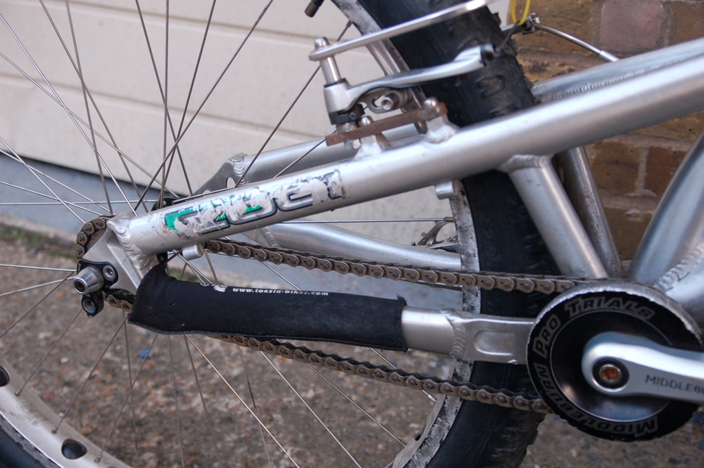

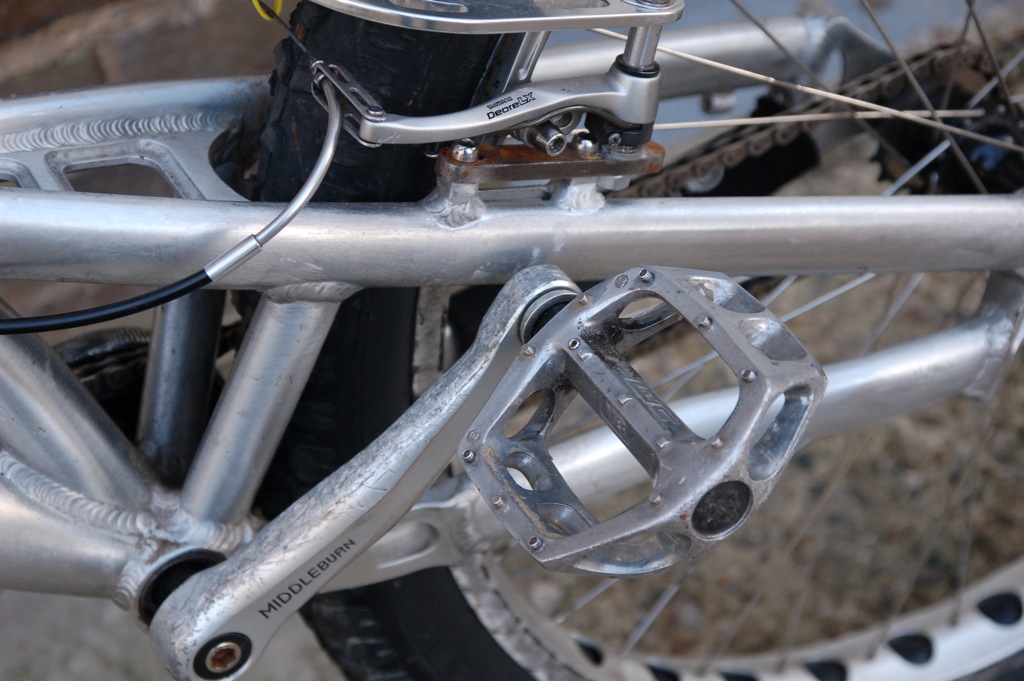

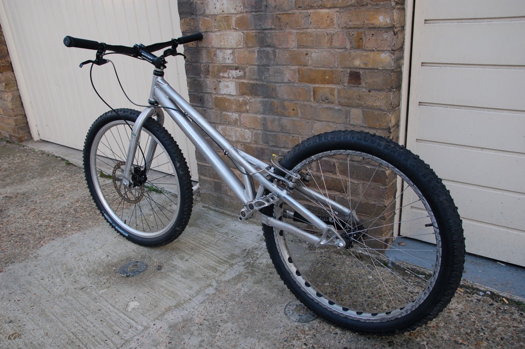

AOK Posted August 31, 2010 Report Share Posted August 31, 2010 Hi guys, So, I joined a week ago and since then have acquired my first ever trial bike. I'm very much a newbie so don't know a lot about these beasts, so any comments would be appreciated greatly! The main question really, is: what's the frame? Its definitely a Zoo of sorts, but is it a Piranha or a Pitbull? And what year? In other news, I was out most of the afternoon yesterday practicing trackstands and stuff... never have I had a) so many blisters on my hands and so much tension in back muscles i never even knew I had! Quote Link to comment Share on other sites More sharing options...
TRD Posted August 31, 2010 Report Share Posted August 31, 2010 i think it may be a Piranha, maybe a 2004-2005? i not quite sure Quote Link to comment Share on other sites More sharing options...
Laurence--Trials Posted August 31, 2010 Report Share Posted August 31, 2010 Looks like a 07 pitbull to me. Pretty nice, could do with some riser bars though. Quote Link to comment Share on other sites More sharing options...
Oldskooltrials Posted August 31, 2010 Report Share Posted August 31, 2010 It's a short 2004 pitbull, I know because I have got the long version of that frame. Quote Link to comment Share on other sites More sharing options...
AOK Posted August 31, 2010 Author Report Share Posted August 31, 2010 It's a short 2004 pitbull, I know because I have got the long version of that frame. Great Thanks for successfully identifying the frame. I'm glad to hear its a short frame as apparently these are easier to learn on? Quote Link to comment Share on other sites More sharing options...

craigjames Posted August 31, 2010 Report Share Posted August 31, 2010 If you're getting back pain, try a higher stem so you aren't as stretched out. Does indeeds look like an 04 Pitbull, pretty tidy; Rich Pearson ran one for a bit and enjoyed it. Quote Link to comment Share on other sites More sharing options...

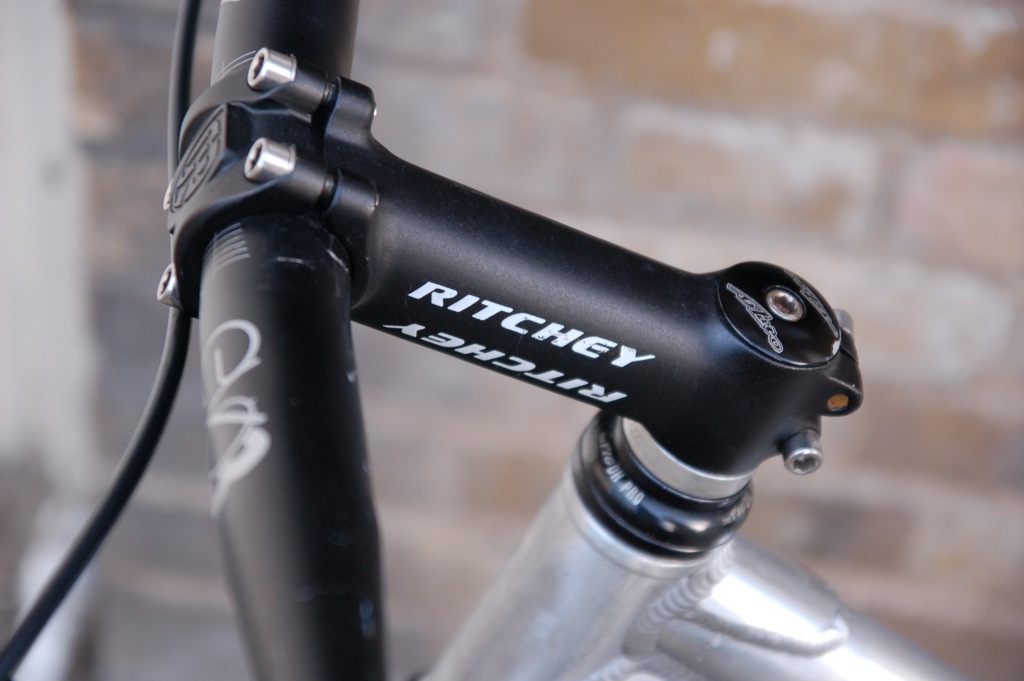

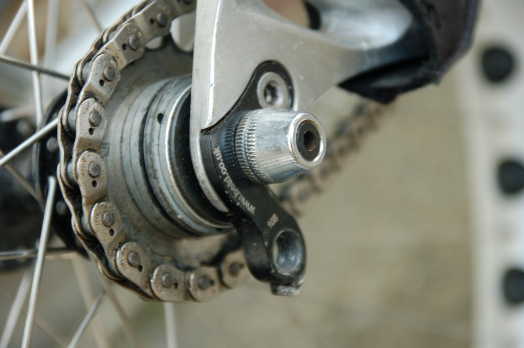

Skorp Posted August 31, 2010 Report Share Posted August 31, 2010 Good buy! in my eyes, you could need something like a 20-25degree*120mm stem and a riserbar. Would make the bike alot easier to get on the rear wheel. Looks like the rear hub is a standard Xc hub..So that might be a thing you change later on. The pads on the rear is for Xc aswell, if the brake is bad you should change them to trials specific. Quote Link to comment Share on other sites More sharing options...
matt rushton Posted September 1, 2010 Report Share Posted September 1, 2010 It's a short 2004 pitbull, I know because I have got the long version of that frame. How can you tell it's a Short? Iv'e got the same frame, But theres no chance you can tell from a picture the length of a bike. Quote Link to comment Share on other sites More sharing options...

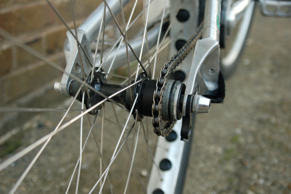

jambo Posted September 1, 2010 Report Share Posted September 1, 2010 Chain looks slack as a wizards sleeve get a Trialtech Z610 HX, 3/32 and a sprung chain tensioner or old short road mech. Quote Link to comment Share on other sites More sharing options...

joea Posted September 1, 2010 Report Share Posted September 1, 2010 it a 04 pitbull mate and looks good but get a back maggie for it the it will be even beter Quote Link to comment Share on other sites More sharing options...
AOK Posted September 2, 2010 Author Report Share Posted September 2, 2010 THANK YOU for all knowledge and advice! Its good to hear I have bought something reasonably good! A few further questions. - So we know its an 04 Pitbull. The one here looks to have a slightly different joint of the top tube and downtube at the front of the bike, indeed all 04 Pitbull's I find have this slight curve up of the top tube which mine doesn't seem to have. Could it be that there were different versions? Or could it be dependent on the difference between the long and medium length frame? And we're not too sure if its a long or short frame... what do I measure to find out? I have done some research and apparently it should be either 1060mm (medium) or 1085mm (long) but what do I measure? - I knew from day 1 that I want to change the stem to a slightly higher stem. Skorp, thanks for the suggestion about the 25degree 120mm stem and riser bar. Wouldn't BOTH a higher stem AND a riser bar be too much additional height? Or is it common practice to do this if you're tall? (I'm 6ft2). Also... would trialtech be a good buy? Or are they all the same? - Brakes! What on earth are my front brakes?? I'm not complaining as they seem to work very well, but are they actually any good? Also, thanks to joea for the suggestion of rear Magura's... how do I go about fitting these? What do I need to buy? can I still use the brake booster currently fitted? - Lastly, rear hub, chain, etc.. I certainly agree that the chain is very loose! Is it normal for the rear axle to have so many spacers on it between the sprocket and the fork? Is it because the hub is of incorrect size or something? Are there any drawbacks to fitting a sprung chain tensioner? Thank you once again for all the help and advice and comments. I look forward to improving the bike whilst I improve myself Went out again today, I'm slowly getting the hang of trackstands and starting to hop around the rear wheel while locking the front brakes up onto small curbs and stuff! Trying to lift the front wheel as of yet I have not achieved. I can launch into a wheelie (about a foot in the air) from near stand still to place it up onto a curb. But raising without propelling forward with pedal power I can't do yet.. but I'll keep trying Anyway, the important thing is I'm loving it.. which is exactly why I bit the bullet and decided to finally buy one Quote Link to comment Share on other sites More sharing options...

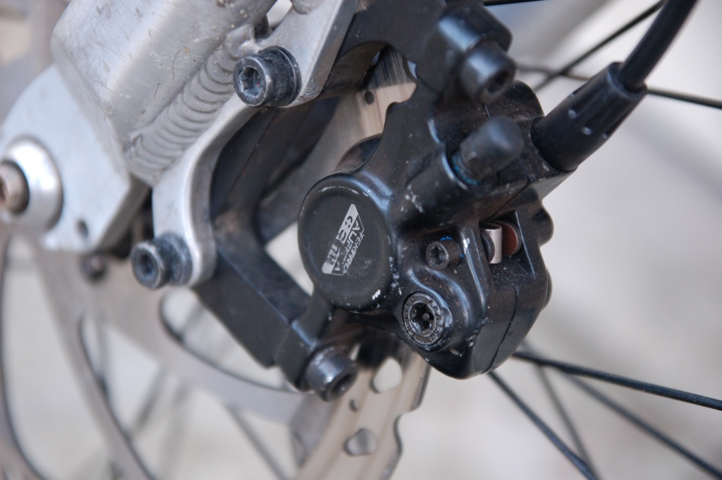

Skorp Posted September 2, 2010 Report Share Posted September 2, 2010 Your front brake is a Tektro Auriga..Its a cheap brake, the ones that i have tried would be ok for trials. Would change it when you start to gap to front, but its deffo good enough for a first bike =) Its alot of spacers on your rearhub because you have a ordinary bike hub. Its built for having 8 or 9 cogs, or kasette as it's called. I had a Trialtech Sport stem, and a Trialtech Sport handlebar on my old Long Pitbull. Felt nice! You should change the handlebar, and not just the stem. Think its like 58cm or something, trials bars should be 70cm ++ You have 25.4mm diameter on your bars aswell, so your handlebar yould not fit most trial stems. You could ask Tartybikes what handlebar and stem they recommend to use on your bike You measure the length of your bike from the front axle to the rear. Quote Link to comment Share on other sites More sharing options...

WIGAN ?? Posted September 4, 2010 Report Share Posted September 4, 2010 (edited) that rear hub looks like a broken face waiting to happen, also there is nothing saying you NEED a rear maggie a good vee setup right will be better than a magura i guarantee, get a nice fresh grind on there and some decent pads job done, that way you can save your money and sort that f**kin hub out Edited September 4, 2010 by WIGAN ?? Quote Link to comment Share on other sites More sharing options...
Skoze Posted September 4, 2010 Report Share Posted September 4, 2010 You will need a rear HS33 from tarty, dont get one just now, get the new one when it comes out (a month or less) and you will need a pair of evo mounts, which you can also get off tarty. No, you wont. A well set up vee with good pads will be just as good as any magura (better, in my opinion) and you'll not need evo mounts, that frame's had some 4 bolt - vee converters bolted on, just take them off and put the maggy with normal 4bolt clamps on if you wanted to go down that route. Smart bike (it's definitely an 04 Pitbull, as has been said previously) change the rear hub for a pro2 and find a bar + stem combo that feels good for you and you'll be sorted for a fair while to come. No problems at all with a sprung tensioner, you seem to have a sensible outlook on everything - do what you think's right and i'm sure it will be Quote Link to comment Share on other sites More sharing options...
AOK Posted September 5, 2010 Author Report Share Posted September 5, 2010 Righty guys, thanks again for yet more advice! I haven't measured her up yet, primarily because it probably is a Long. Confirming that won't actually do me a favours! I bought what I bought, now I just gotta make do, whether its long o short! As for the other stuff... 1) Chain tension The chain admittedly is very slack, and for one reason or another I don't want to fit a sprung tensioner. What about snail cams? What are they, how do they work? Is their purpose to keep the chain taut? And in my case, is it the black thing with writing on it, visible in this pic: 2) Rear hub.. So how come my hub looks so terrible? Is it just very basic or something? Looked into the Hope Pro 2 you guys recommended.. pretty damn pricey!! Will have to find an alternative. Out of curiosity, is it easy to swap in a new hub? I'm more thinking about the spokes.. surely that's a damn difficult job?? 3) Rear brakes I'm guessing that lack of critique means that, as v-brakes go, the Shimano I have isn't a bad way to go, right? Because I'm thinking to save the £75 for the Magura set up and just stick with the Shimano.. especially as everyone is praising V set ups! but what can I do to make it more aggressive.. new pads I suppose? Would re-grinding REALLY help?? REALLY appreciate all the help! Quote Link to comment Share on other sites More sharing options...
trialsmax04 Posted September 5, 2010 Report Share Posted September 5, 2010 There is no way you can run snail cams, as it is vertical dropouts. They only work with horizontal drop outs. Nothing wrond with a sprung tensioner..... Quote Link to comment Share on other sites More sharing options...
