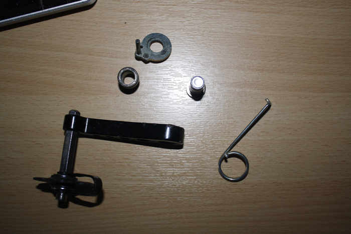

I was taking it off my old frame and about to move to the new and the spring sent it into the sky. I was wondering how to put it back together and if i have all the parts.
http://www.tartybikes.co.uk/product.php?product_id=10179&category_id=48 Its very similar to this one
Ive attached a photograph.
Thanks for your help!

Looks like you have everything there. The 'pin' from the spring goes into that little disk with the locator arm on it, and the spacer goes in the middle of it all. The end of the spring goes onto the arm by the jockey wheel - that's pretty much all there is to it.
Ok from what I can work out, the short arm from the spring goes into the hole on the round plate. the spacer goes into the arm with the bolt going through it. The round circular plate which you put the spring on then goes onto the opposite side of the arm from the bolt head, ensuring the locating pin on the plate faces away from the arm.
Hope I helped
James
Sorry, my description as pretty much the same as the one above
