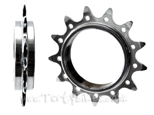

isitafox Posted August 24, 2010 Report Share Posted August 24, 2010 Don't know what to say really as getting a new BB is a big spend, especially if that doesn't solve the problem and I'm assuming the rear sprocket is set to one side on the thread not centred like this http://www.tartybikes.co.uk/images/sprockets/large_tascrewon.jpg Quote Link to comment Share on other sites More sharing options...
swiftspeed star Posted August 24, 2010 Author Report Share Posted August 24, 2010 Don't know what to say really as getting a new BB is a big spend, especially if that doesn't solve the problem and I'm assuming the rear sprocket is set to one side on the thread not centred like this http://www.tartybikes.co.uk/images/sprockets/large_tascrewon.jpg yeah both having a centered tooth sprocket and turning the current one around would make it worse and the bb is what rock 'n' roll bikes said we needed. Quote Link to comment Share on other sites More sharing options...
