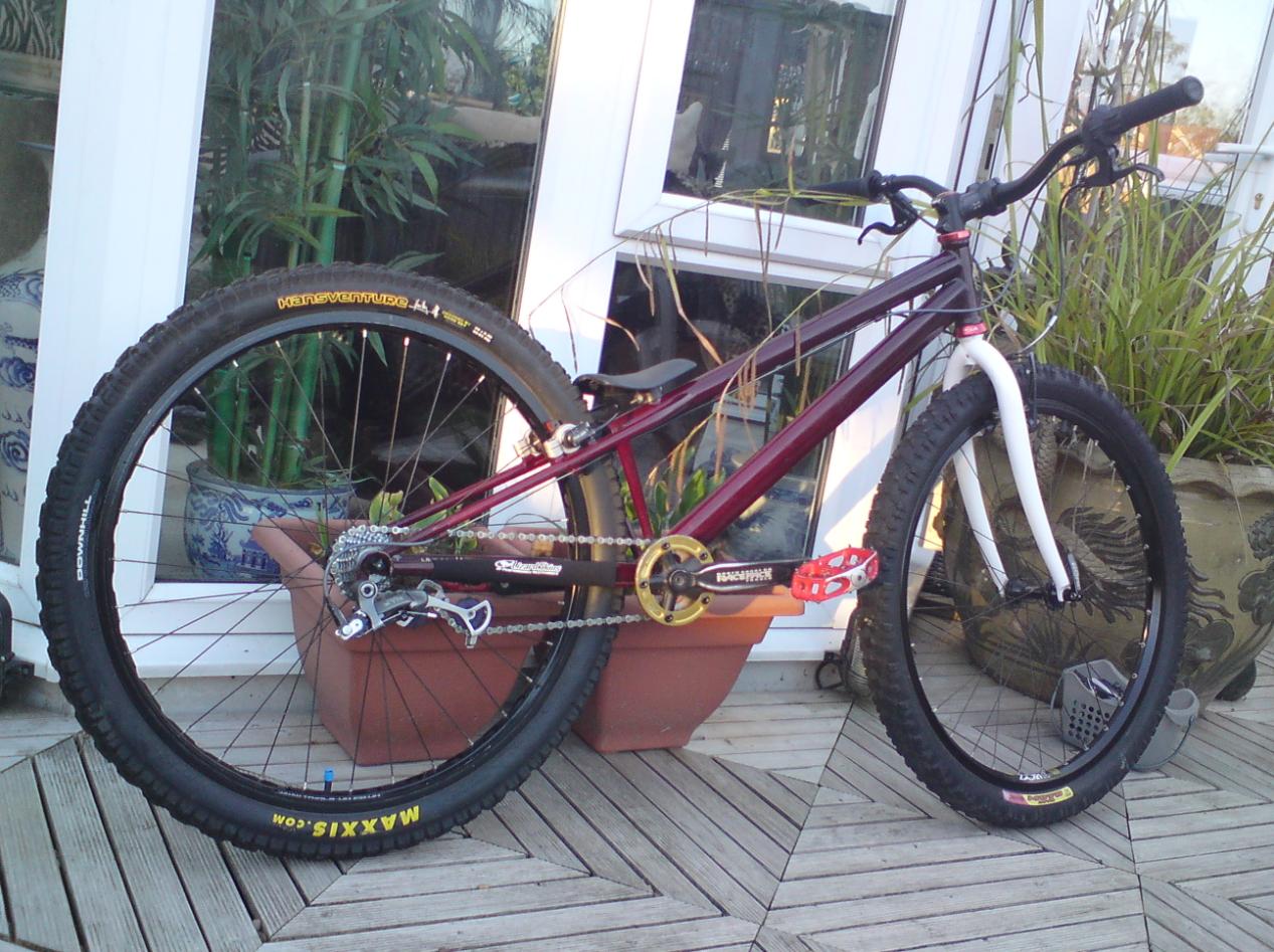

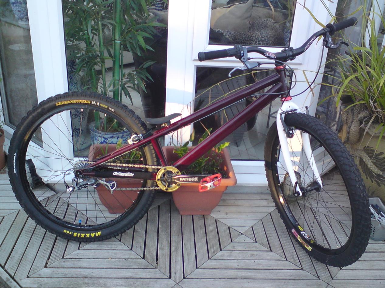

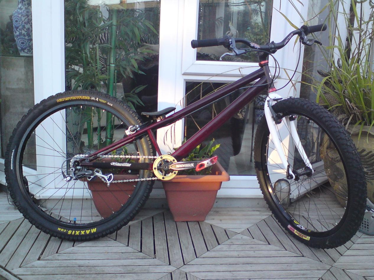

Cheers! Once again it took years of fine bar & stem adjustment, but I like it.
I read somewhere the stays are 384mm, looking at it, I'd say realistically they couldn't be any shorter, so even though it's tiny short it's still decent on the back wheel.
Wheelbase with pashley forks is about 1014.
The bb looks rougly a 4/5mm drop from the axles.
Head angle is probably 72/73 ish, steeper than I'd like but the short rear & bb drop make up for it. I wanna try find some slightly longer forks, 405-410mm, basicaly lite guys but with strength.
I'll try get some decent pics tonight if the sun comes back.
Chars!
It's off Edmondraptor on here, The bars are the old model Azonic b-52 (before the azonic shape went awful) supposed to be 2" rise but they're more like 2.5" as the 31.8 clamp makes the rise look lower, replacing them with some Answer pro tapers tonight, same sorta thing but they were too cheap to turn down.
Yea bar angle can make or break a bike for me lol, 2 0r 3 degrees either way & it's ruined lol.
It's definitely no orange zero in terms of bunnyhops but it's the closest thing I've ridden behind a zebdi & a norco, but in return it's way better than those on the back wheel.
You do feel the weight, it's probably a tiny bit less than a marino but I wanna go back to a rear D521 & get rid of this echo urban thing, but I'm not sure the pads will reach unless I get brand new ones, even then it'd be a stretch! I hate 4 bolt mounts & most modern things lol.
And the marino's...I just gave up, little tweaks here & there but just couldn't get what I wanted, the last one's wheelbase came up quite a bit over, frame was a month late, and I don't think a cheap custom frame can ever compare to a production one, shame, I could have bought 4 of these with the money I spent on marino's lol.

What about some Tensile mounts to let the brake come in closer? Or even some metal backing pads? The old mk1 Heatsink ones added a huge amount of breadth/height from the piston.
Look forward to seeing full bike pics if you get round to it. Oh, plus, I know of the boy you bought it from but it wasnt mine.
I've heard the tensile mounts are useless for narrower rims, only good for wider as they stick up bit where the hoses screw in hits the edge of the mount anyway so you can't get it any further inwards, I may be wrong but I did look & that's what I read. Might just go for some beefier pads.
