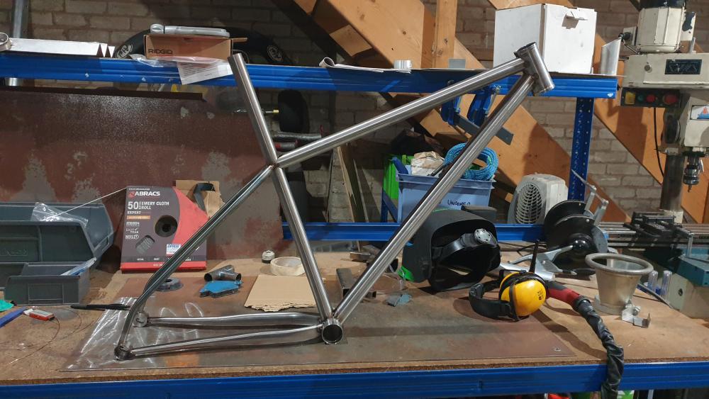

AdamR28 Posted January 12, 2021 Report Share Posted January 12, 2021 Thanks for your input guys! I also think eccentric BB would be easier for adjustment - though in considering this, it has made me ponder why the eccentric system at the dropouts is awkward. Yes you can move the wheel around, but only on a prescribed circle. You can't just nudge it directly up a bit here, or horizontally back a bit there, for example. So, I've come up with something else that may or may not work, we'll find out in a few weeks 1 Quote Link to comment Share on other sites More sharing options...

AdamR28 Posted March 9, 2021 Report Share Posted March 9, 2021 Thanks Ross, I think that's the same one as earlier in the thread? I've ended up with a kind of semi horizontal dropout, so in theory you can just sit on the bike with the drive side wheel bolt loose, then tighten it up... No close up photos on my phone but can maybe make them out here... Basically a neat, modernised version of oldskool road bike dropouts! Quote Link to comment Share on other sites More sharing options...
