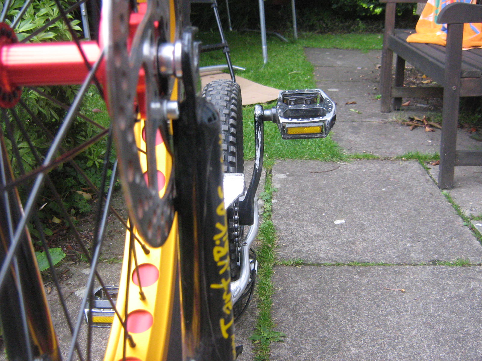

Hey
heres a picture of the problem
Im buying new forks tomorrow so i would really appreciate it if i could sort this out today

Hey
I've just put one bolt on, you see it?
post-26782-074585400 1280860430_thumb.jp
What forks are those?
There doesn't appear to be much room between the rotor's braking surface and the fork leg which could be due to the hub not being spaced quite so nicely as others, though that may just be the angle the picture is taken from.
The rotor also rubs on the forks yes :angry:
What can i do?????!!!!!!! :$
please help :lol::giggle:
Then either the spacing on your fork or on your hub is out. If there's no way to move the hubshell along the axle with spacers at all then your best bet shy of new parts is to try facing the disc mount on the hub a little, though if it's far enough out for your rotor to run the fork leg then facing probably won't help
What forks are they?
I imagine its more with the fact that they're cheapo steel forks with the dropouts welded central to the fork leg. Unfortunately if it won't space out and wont work with proper Torx disc rotor bolts then it's new forks time, certainly a worth while upgrade.

In that picture your wheel is the wrong way round so the rotor is on the driveside, not the disc mount side. Sometimes the fork will have a flattened section of leg to give more room and prevent issues like this. The fork does have a disc mount, right? Try it in the right way and see what it's like...

Is it me, or is his disk on the wrong side of the hub?, well the rotor is on the right side, instead of the left (correct) side of the forks?
It doesn't matter because I've tried it both ways round and it still doesn't fit right.

Those original steel Monty forks don't have a disc brake mount, were never intended for discs and therefore won't clear a disc whatever you do.
