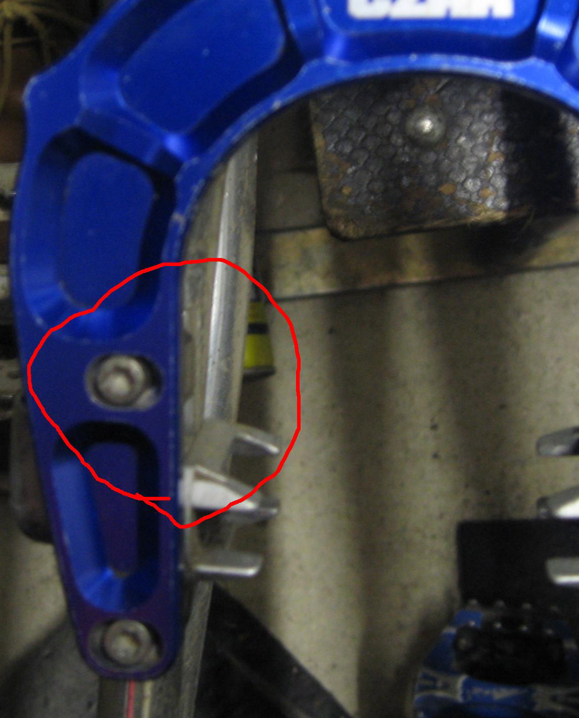

t-comp-kierz Posted July 23, 2010 Report Share Posted July 23, 2010 I was fixing my brake and ended up rounding the bolt that holds the maggie mounts on I have tried to get it out using a bigger allen key but it didnt fit I cant saw a slot in the bolt to use a screw driver And now im stuck for ideas How can i get the bolt out? Quote Link to comment Share on other sites More sharing options...
PeanuckleJive Posted July 23, 2010 Report Share Posted July 23, 2010 mole grips or find a torx key (the ones that are like a 6 pointed star) a little bigger than the hole left by the allen key *** it in, hopefully give you enough grip to turn the bolt loose why can't you cut a slot in it? Quote Link to comment Share on other sites More sharing options...
t-comp-kierz Posted July 23, 2010 Author Report Share Posted July 23, 2010 (edited) mole grips or find a torx key (the ones that are like a 6 pointed star) a little bigger than the hole left by the allen key *** it in, hopefully give you enough grip to turn the bolt loose why can't you cut a slot in it? Mole grips wont work either as the bolt is in the booster Edited July 23, 2010 by t-comp-kierz Quote Link to comment Share on other sites More sharing options...
PeanuckleJive Posted July 23, 2010 Report Share Posted July 23, 2010 Got a dremel? If you get a dremel with a tiny little cutting disc, you should be able to cut a slot into it to use a screwdriver you might scratch your booster a little if you're not careful. But it might be a price you have to pay Quote Link to comment Share on other sites More sharing options...
l33th3tr33 Posted July 23, 2010 Report Share Posted July 23, 2010 Try taking all the bolts out except that one, (obviously) and turn the booster. Might loosen it off enough to spin it loose with your fingers. Quote Link to comment Share on other sites More sharing options...
AdamR28 Posted July 23, 2010 Report Share Posted July 23, 2010 If you take all the other 3 bolts off, you might be able to use the booster itself to loosen the bolt - there should be enough friction between the booster and the underside of the bolt head to rotate the booster anticlockwise and get the bolt moving. Once it's loosened off a little bit, you should be ok from there. Quote Link to comment Share on other sites More sharing options...
l33th3tr33 Posted July 23, 2010 Report Share Posted July 23, 2010 I just said that! Quote Link to comment Share on other sites More sharing options...
t-comp-kierz Posted July 24, 2010 Author Report Share Posted July 24, 2010 Now im really f****d i have now rounded the bottom bolt on each side :$ any one got ideas how im going to get it ? Quote Link to comment Share on other sites More sharing options...
rab shropshire Posted July 24, 2010 Report Share Posted July 24, 2010 have you tried hammering a larger allen key into the bolts to get them off, if not you coul just cut the bolts below the booster Quote Link to comment Share on other sites More sharing options...
t-comp-kierz Posted July 24, 2010 Author Report Share Posted July 24, 2010 (edited) have you tried hammering a larger allen key into the bolts to get them off, if not you coul just cut the bolts below the booster Yeah tried that, didnt work Think cutting them is going to be my only option Edited July 24, 2010 by t-comp-kierz Quote Link to comment Share on other sites More sharing options...
modifiedridah2k9 Posted July 24, 2010 Report Share Posted July 24, 2010 Yeah tried that, didnt work Think cutting them is going to be my only option Could you use an adjustable spanner and tighten it onto the bolt and twist it off? Just an idea mate. Quote Link to comment Share on other sites More sharing options...
rab shropshire Posted July 24, 2010 Report Share Posted July 24, 2010 yeah it sounds like that, you could try super glueing an old allen key into the bolts first to see if that works Quote Link to comment Share on other sites More sharing options...
N.Wood Posted July 24, 2010 Report Share Posted July 24, 2010 Could you use an adjustable spanner and tighten it onto the bolt and twist it off? Just an idea mate. He's just said and shown theres not enough space for mole grips or an adjustable in there. Quote Link to comment Share on other sites More sharing options...
modifiedridah2k9 Posted July 24, 2010 Report Share Posted July 24, 2010 He's just said and shown theres not enough space for mole grips or an adjustable in there. Sorry I didn't see it and i don't really know what mole grips are :$ Yeah Rab's idea sounds best Kieran, supergluing an allen key into the bolts a great idea. Quote Link to comment Share on other sites More sharing options...
raoulduke Posted July 24, 2010 Report Share Posted July 24, 2010 Sounds like your Allen key is rounded also. Can you get a Saw blade between the Booster and the Maggie mounts? If so I'd just cut the bolts at this point. Good luck! Quote Link to comment Share on other sites More sharing options...
