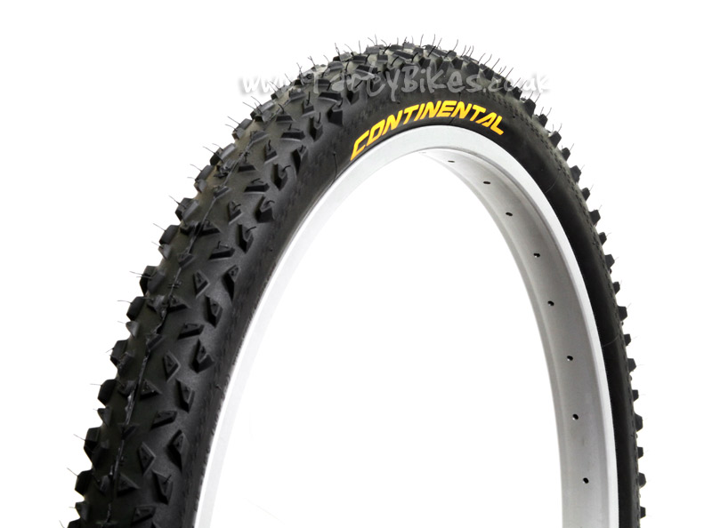

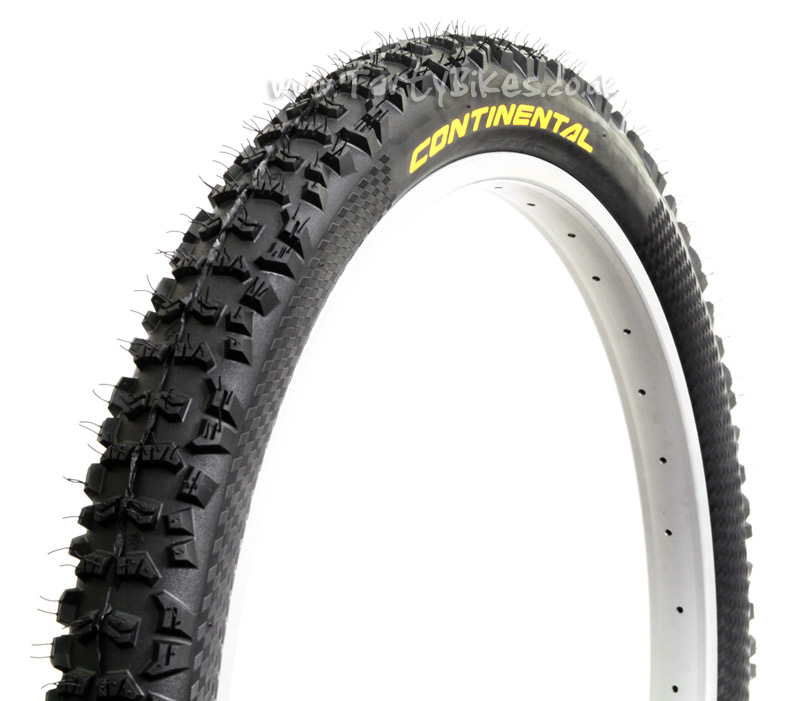

These are braaaand new - the new Trial Queen and Trial King from Continental.
The Trial Queen is created using the same carcass of the Rubber Queen 2.2", with the Apex inserts of the 2.4" version, with the compound of the Der Kaiser/Rain Kings. It's essentially a hybrid of those three, taking all the best aspects of them to create one of the best tyres available. Weight: 848g
The Trial King is created using the carcass of the Mountain King 2.2", again with the Apex inserts and again also using the Der Kaiser/Rain King compound. Weight: 648g
Compound feels awesome on these tyres - they almost feel sticky to the touch!

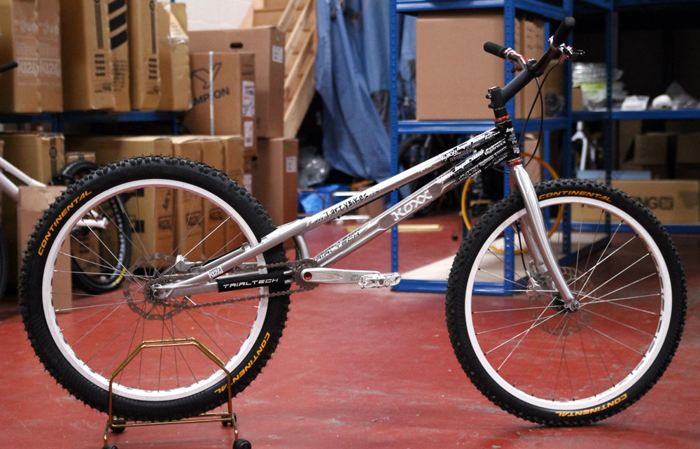

Adam has a pair of these on his Hydroxx and when we rode the rocks at Blackburn yesterday they seemed pretty awesome. He had single ply Maxxis f+r before and these looked noticeably grippier. Was comedy seeing him ride the rocks with little loose gravel at the base 'cos the gravel just sticks to these tyres and then flicks off - pretty much took half of Blackburn with him...

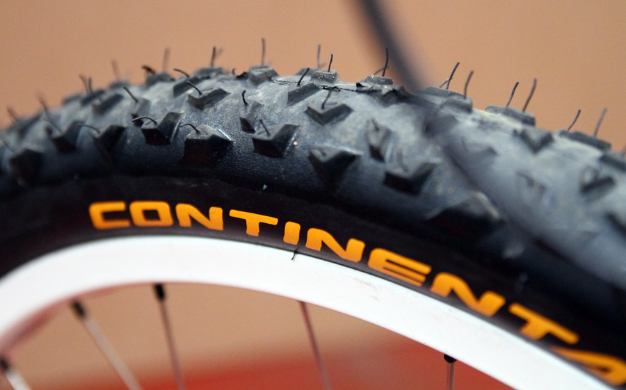

Cross-posting from OTN where a few people were asking for first impressions:

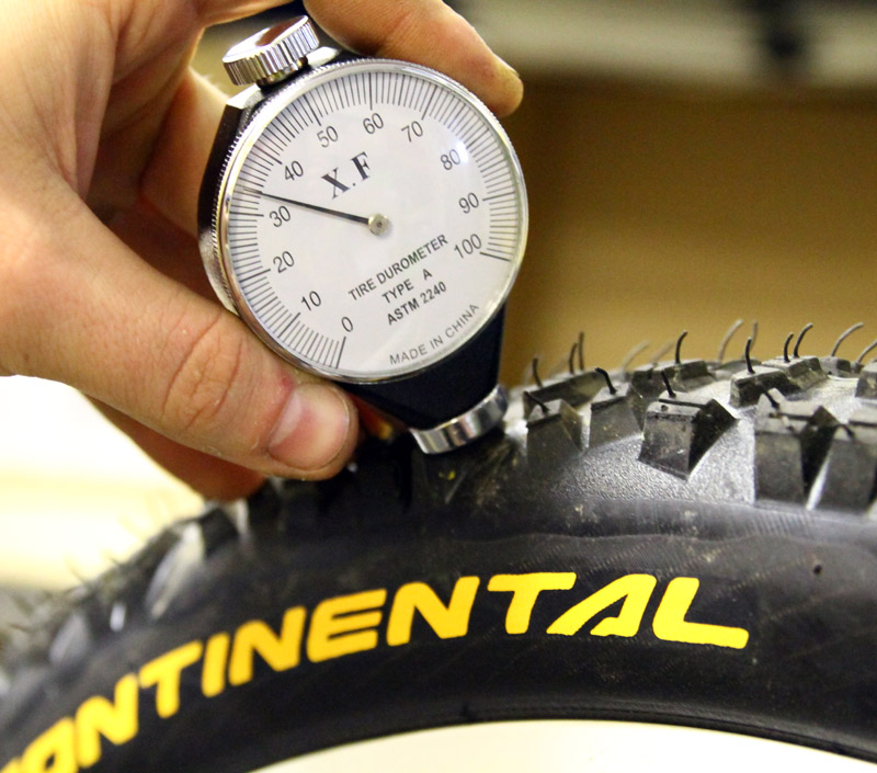

Here's some photos for you... indoor cos it's weeing it down!

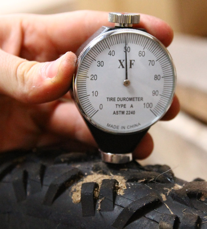

And for a comparison with a Try-All Stiky Lite 19" (which is the same compound as a Maxxis Super Tacky 42a, which also measure the same as the Try-All on our gauge):
:o

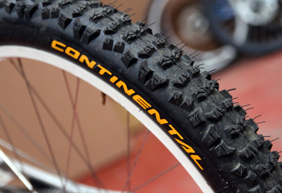

First ride impressions:
Grip - easily as good as my Maxxis and definitely better than 2.4" Rubber Queen, but the release agent is still wearing off the tyres so it will improve in a couple of rides as usual. The compound is super soft (see above), you can 'smear' it all over the place and it will return to shape like some kind of slow gunge, crazy stuff. Will update on the wear (although should be good like the Rain King and Kaiser) and grip after more riding...
Stability - The rear is definitely more stable than a 2.4" Rubber Queen, and more stable than the 2.5" Maxxis Hi Roller Single Ply I had on before. The Apex insert is deeper (goes further up the sidewall of the tyre) and thicker/stiffer than the 2.4 RQ, it's kinda like a 50-60% thickness version of the sidewall insert in the Rain King and Der Kaiser. The overall tyre size is a bit smaller than the 2.4" RQ which seems to help with stability too. Landed a few gaps down onto angled pointy rocky things and expected the tyre to squirm over then 'ping' back but it didn't, which was suprising.
The front carcass is identical to a 2.2 Mountain King, except with a thicker sidewall. The insert on the front isn't quite as thick as the rear, maybe 75% the thickness/stiffness. I found that if you push the tyre pretty hard into stuff, it doesn't 'pop' and 'spring' back in an uncontrollable way like a super light tyre does. The extra damping can help to improve grip in certain situations I think, but as with anything you can learn to use it's strengths to your advantage.
Puncture resistance - I don't puncture all that often (apart from the front - ask Mark :P ) and didn't hit the rear rim at all on Saturday's ride, but I'm confident the puncture resistance will be better than a 2.4" RQ, simply because the sidewall is stiffer and thicker. It definitely won't be quite as good as a Kaiser/Rain King though!

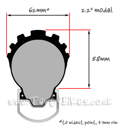

Just re-measured one on Adam's bike and it seems to be 62mm wide and 58mm tall, which is obviously a bit more than we worked them out as being. Iiiiinteresting...
Bigger than a rubber queen 2.4, it is a shame.
it is hard to fit rubber queen 2.4 in some frame already.
They should have keep the size of the original 2.2 for this particular reason. Moreover the tire could have been way lighter that way!
