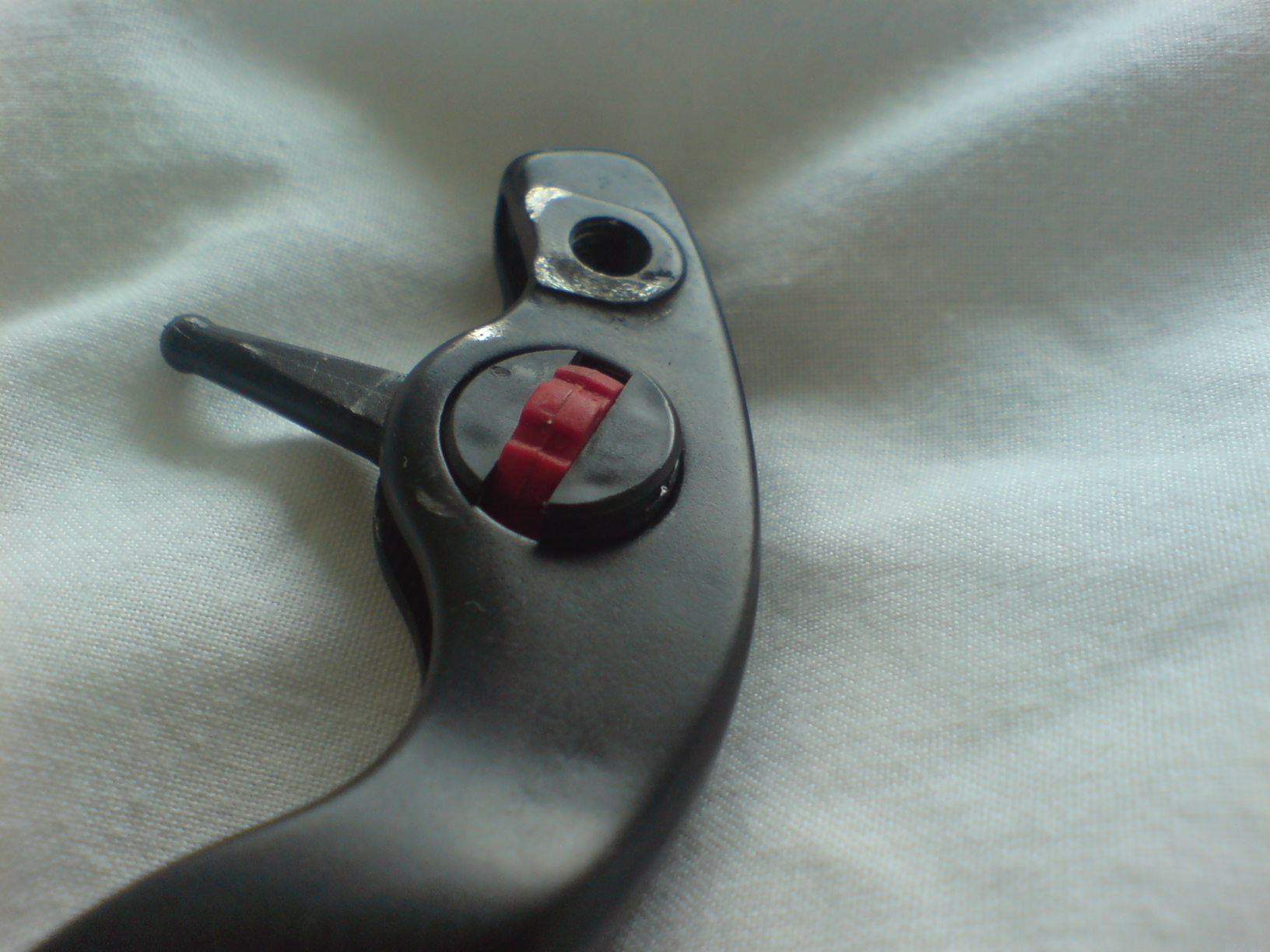

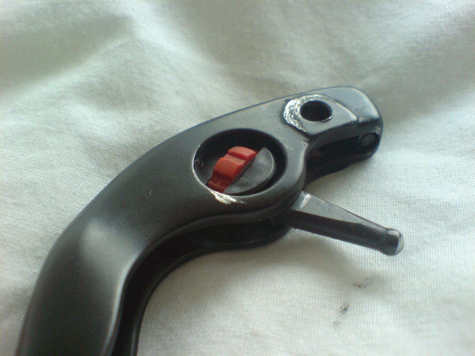

I was out riding yesterday and noticed my brake lever was sticking a bit, so I took a look at it and the TPA dial has gotten out of place inside the lever, hopefully pics should help you understand what I mean a bit more :P
Does anyone know how I can get it back in?

I think you should be able to just push it back in.

if the tpa still turns... then turn it so the pin comes out.
then the tpa and plastic cone things should pop back into place a little easier and fall out the lever (Y)
this happened to me before, and i fixed it that way (Y)
be patient with it and just keep trying, it should eventually come out if it doesnt at first
