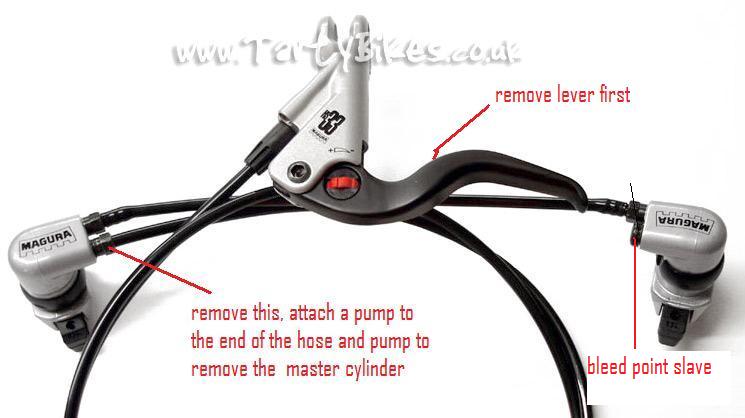

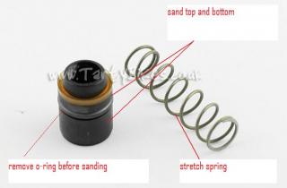

rab shropshire Posted June 26, 2010 Report Share Posted June 26, 2010 (edited) I will have another go at explaining this, may help anyone with the same problem. Basically this is how you fix a stiff master cylinder (stiff lever) 1. First of all you need to remove the lever blade from the body. 2. Next you need to remove the piston and spring from the lever body. this can be done 2 ways a. attach a pump to the end of the hose as shown in the second picture and just pump untill the piston pops out. (be carefull as with the air pressure the piston can fly out quite quickly) b. with the brake still on the bike attach a syringe filled with fluid to the bleed point on the slave, and force the fluid through the system this should pop your piston out of your lever body. (ensure yourpads are hitting your rim before you use this method so as not to damage your slave cylinders) You now should have a piston and spring in your hand as shown in the first picture. 3. Remove the rubber o-ring from the piston so it doesnt get damaged. 4. Sand a tiny bit of your piston all the way round ( above and below where you o-ring would be) only do a little bit each time and keep checking for a correct fit. 5. Once you have a good fit give every thing a good clean and lube. 6. Give your spring a little stretch 7. Pop everything back together 8. Give the system a good bleed (ensure your tpa is fully wound of before starting to bleed) This should solve your problem, if you need any more help give me a shout Edited June 26, 2010 by rab shropshire Quote Link to comment Share on other sites More sharing options...
