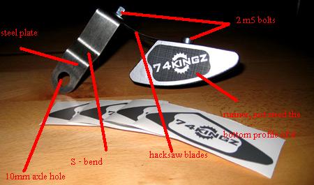

* Tensioner
  • Hacksaw blades x2 / big vibra saw blade
  • Bit of piping / plastic for runner
  • some steel for the angle bracket
  • 2 m5 bolts and washers ( I use rotor bolts )
Bend the Steel into an L shape so it clears the rear cog.
Put an S bend into the steel so the end is bought into line with the cog
Drill ends of both blades and the ends of the steel to accept the axle (10mm usually ) and the M5 bolt ( 5mm ).
Drill the runner you have made and affix to hacksaws.
Should look approximately like this....
* Tensioner
