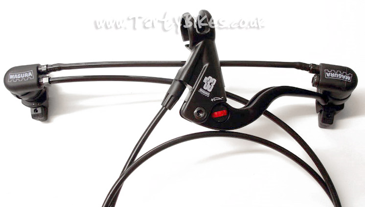

JackZOO! Posted June 16, 2010 Report Share Posted June 16, 2010 Hey, For a starter bike, I believe that you should really think about what bike to buy. You should take into account the brake setup and I shall explain it to you in detail. There are a couple of different brake setups but i will explain a handfull of them to you. Double Hs33:Double Hs33 is one of the best brake setups. It is good because the brakes hold well of smooth or ground rims(Ground meaning ground down with a disc grinder). Unfortunatlly they are also expensive, at the price of £59.99 from www.tartybikes.co.uk for a single brake. They do not have to be maintained as much as disc brakes and last for a while. Hs33's are also hydrolic rim brakes so they need bleeding once in a while but that is easy enough once you've watched some video guides. Double Disc: Is a very expensive brake setup. Each brake can cost up to £100 or more! There are 2 different types of disc brakes. Cable disc brakes, like V-Brakes, and hydrolic disc brakes, like hs33's using liquid for the brake to operate. For a starter you should not really buy a frame or bike with double disc, and the brakes have to be mainted often otherwise the preformance will decrease. As you can proabally tell, hydrolic discs are better than cable, but come at a price. A big advantage is that double disc means sharp braking, which is proabally not a good idea for a starter bike. Front Disc Rear Hs33: Front disc and rear hs33 is proabally the best setup, or most used setup in trials. This is because you get a nice sharp front brake for moves like stopies etc and a grippy rear hs33, which can work even better on a ground rim. I would personally recomend this brake setup, however it is quite costly for both of these brakes. I would say you should upgrade your forks once your used to riding and put a nice sharp responsive disc on the front. Double V-Brake: Double V-Brake is the cheapest setup, and can be one of the best if setup correctly. I would also recommend this to any starter. They brakes can again be nice and sharp of ground or smooth rims but also can be fearthed easily. However, If you buy a frame with V-Brake mounts, and you want to upgrade to hs33's, then you need to buy a new frame. This is one disadvantage of V-Brakes so it is important you make the right choice first time. Here are a few bikes I would recomend that you condiser buying. Each one has the brake setups I was talking about. Bike:Onza Rip Price:£319.99 Brake Setup:Double V-Brake Bike:Onza Pro Price:£489.00 Brake Setup:Double Disc Bike:Onza Comp I recomend This bike! Price:£529.99 Brake Setup:Double Hs33 Bike:Onza Blade Price:£589.00 Brake Setup:Disc Front, Hs33 Rear I hope this information helps you and aids you to make your choice about brakes Quote Link to comment Share on other sites More sharing options...

davey1991 Posted June 18, 2010 Report Share Posted June 18, 2010 Mostly wrong stuff. I'm sorry but if he takes that advice he'll loose knwledge rather than gain it. Maguras require more maintenance than disk, the pads wear far quicker so the brake needs to be adjusted to take this into account, the pads are far more difficult to align so it takes alot more time. They are ok on smooth rims but if it gets wet your probably going to be wanting a disk. Dual disk is great on mod there is nothing that says you shouldn't and it is deffinatley not a bad idea in anyway. You talk about sharp breaking, disk brakes are great for one thing, they have more modulation than maggies, this means they aren't as sharp to start with. Hydro disks are no better than mechanicals if set up correctly infact i much prefer mechanicals they feel much more solid and more feel to the braking as your physically conected to the brake. Vee's are amazing brakes, if you set them up well they will out perform most other brake setups. You do not need to change a frame to run magura's you buy an EVO 2 adaptor. It seems like you were just talking for validation votes there and giving some not brilliant info. This above is only a vague insight but it is how each works. Quote Link to comment Share on other sites More sharing options...
