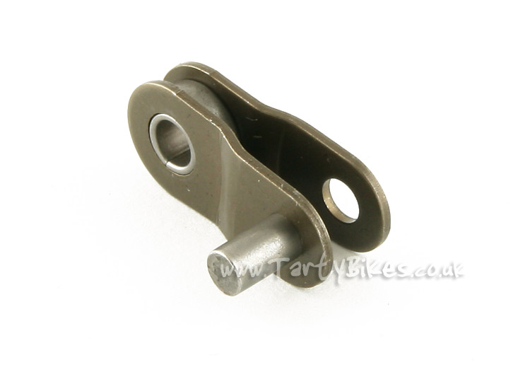

Bigman Posted June 6, 2010 Report Share Posted June 6, 2010 I know it might not be the best solution, but how about adding a full link and running a spoke tensioner? This is what the half link should look like: Adam Quote Link to comment Share on other sites More sharing options...
Sethgun Posted June 6, 2010 Author Report Share Posted June 6, 2010 I know it might not be the best solution, but how about adding a full link and running a spoke tensioner? This is what the half link should look like: Adam yeh ive got a couple of thos half links on but really, they are still the same overall length as a full link thats what gets me. Spoke tensioner......where did i see that here? u got a link? I think one of the tarty boys did that in a post...... Quote Link to comment Share on other sites More sharing options...

monkeyseemonkeydo Posted June 6, 2010 Report Share Posted June 6, 2010 ive got a couple of thos half links on Then you're doing it wrong... the point of a half link is that one of those can replace a 'full' link (that is one narrow and one wide link) of a normal chain so you can reduce the length of the chain by 1/2" (the length of a single link). Quote Link to comment Share on other sites More sharing options...
Sethgun Posted June 6, 2010 Author Report Share Posted June 6, 2010 Then you're doing it wrong... the point of a half link is that one of those can replace a 'full' link (that is one narrow and one wide link) of a normal chain so you can reduce the length of the chain by 1/2" (the length of a single link). Actually yeh crap, ur right....if u put a narrow link together with the sides of a 2nd link, uve got an open end and a closed end (if that makes sense) a single half link gives u an open and closed end on a single link. Might have to play around and use 2 or 3 half links to get the tension spot on true? Its as if all i need is half a single link and ill be spot on, working with a few half links might end result in this somehow, ill play now Quote Link to comment Share on other sites More sharing options...
Al_Fel Posted June 6, 2010 Report Share Posted June 6, 2010 Actually yeh crap, ur right....if u put a narrow link together with the sides of a 2nd link, uve got an open end and a closed end (if that makes sense) a single half link gives u an open and closed end on a single link. Might have to play around and use 2 or 3 half links to get the tension spot on true? Its as if all i need is half a single link and ill be spot on, working with a few half links might end result in this somehow, ill play now You do realise that 2 half links make a full link right? Quote Link to comment Share on other sites More sharing options...
monkeyseemonkeydo Posted June 6, 2010 Report Share Posted June 6, 2010 If with a completely normal chain you're either just short or then just too long by adding another complete link (that is a pair of normal links) then by adding a single half link to the shorter chain you should be in the ballpark. You should never need to use more than one half link otherwise you're just weakening your chain without gaining anything. You do realise that 2 half links make a full link right? But two lefts don't make a right and two wrongs don't make a right. Right? Quote Link to comment Share on other sites More sharing options...
