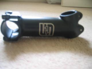

Laurence--Trials Posted May 31, 2010 Report Share Posted May 31, 2010 (edited) I dont know the Geo on this stem and i need to know i think its atomz was £30 on tarty when it was sold i think. Anyone help? Laurence. Edited May 31, 2010 by Laurence--Trials Quote Link to comment Share on other sites More sharing options...

MiuSliS Posted May 31, 2010 Report Share Posted May 31, 2010 Indeed. Measure the length because i'm pretty sure it's 25degrees, but you never know. Quote Link to comment Share on other sites More sharing options...
Laurence--Trials Posted May 31, 2010 Author Report Share Posted May 31, 2010 Where do you measure it from and to and where do u measure the angle? Quote Link to comment Share on other sites More sharing options...
DannyBazz (: Posted May 31, 2010 Report Share Posted May 31, 2010 where do u measure the angle? There are some extremely dim people in this world, and you are one of them Quote Link to comment Share on other sites More sharing options...
Laurence--Trials Posted May 31, 2010 Author Report Share Posted May 31, 2010 Ok im guessing if the stem is facing right its on the top part? But what about the length? is it from the start of the main 'tuby' bit? Quote Link to comment Share on other sites More sharing options...
rab shropshire Posted May 31, 2010 Report Share Posted May 31, 2010 measure the length from where the centre of your steerer tube would be to where the centre of your bars would be Quote Link to comment Share on other sites More sharing options...
monkeyseemonkeydo Posted May 31, 2010 Report Share Posted May 31, 2010 Angle is relative to the steerer and length is from the centre of the steerer to the centre of the bar (i.e. the 'effective' length of the stem, rather than just the length of tube between the two clamping points). Quote Link to comment Share on other sites More sharing options...
flatpro Posted June 1, 2010 Report Share Posted June 1, 2010 I have this stem and it's 120mm 25° . but I'm not quite sure if there is only one version of it available. Quote Link to comment Share on other sites More sharing options...
Laurence--Trials Posted June 1, 2010 Author Report Share Posted June 1, 2010 I measured the stem and its 20deg and 120mm. Cheers for help guys Quote Link to comment Share on other sites More sharing options...
