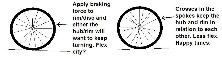

JD™ Posted May 26, 2010 Report Share Posted May 26, 2010 Question the first. My tensile 96 click developed alot of side to side play, so I checked the lock ring and it was nice and tight, I then took the freewheel apart and noticed there are a few shims inside, so what I have done is removed one of these to allow the lockring to tighten further and now there is less play in it. Basically what im asking, is it ok to remove one of these shims or am i about to have a trip to the dentist. Second question I am thinking of building my new front wheel with radial lacing, the hub i will be using is a non disc echo tr. I have heard that radial lacing is a bad idea but never been able to understand why. So the question is, will it be ok to radially lace my front wheel. Thanks in advance for the advise. Front freewheels are something I know absolutely nothing about, so I'll leave that to someone else. Radial lacing is something that was debated for ages and just seems to have gone away a bit. I personally like the look of it but wouldn't use it. The point of crossing spokes in a wheel build is to make the wheel stronger. I'm gonna need to be drawing me some pictures I reckon... Here's one I've just knocked up to hopefully help you: Basically it's more flexy but lighter and sometimes aesthetically more pleasing to go radial. It's stronger and a little heavier (but bugger all really) to go with a 3x cross pattern. The other option is to go 3x on the disc side (if you're running a disc) and radial on the non disc side... Quote Link to comment Share on other sites More sharing options...
