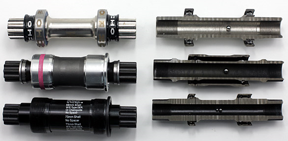

There's a picture on Echobike.com when you click 'Urban' on the left menu, that shows you cut-aways of various ISIS BBs..
I was trying to choose a bottom bracket, but now I am trying to figure out how the heck they manage to put the ball bearings into the integrated races! Looking at those cut-aways it looks like one fiddly job!
post-25205-0-68573600-1290335720_thumb.p
