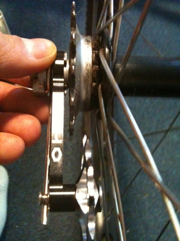

I've just bought a Echo tensioner brand new from tartybikes, it's for the TR hub.
I've gone to fit it and have found that the cog on the tensioner doesn't line up with the cog on the hub.
I'm guessing I need to change the cog on the hub, but could do with any advice.

No, the jockey wheel isn't adjustable.
I've not seen the spoke design, but surely this would wear the chain quickly.
Reason I went for the Echo tensioner was because it sits on the axle rather than the mech hanger.
Not come across this issue before, but as has been said, you should be fine with a sprocket that has it's teeth in the centre.

Cool, cheers for that Adam.
I just figured as I had the Tr hub, the TR tensioner would fit no problem, I didn't think about the teeth's position on the sprocket.
