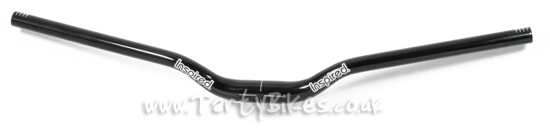

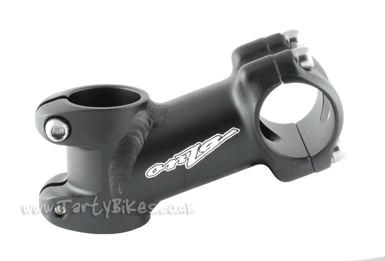

I'm running a raceface 110mm*10degree and some 3" rise gusset prison bars (Which are more like 2.5" rise really)
But think I have compromised on trialsyness quite a bit. They're jump bars really, not v wide, but sweet for street
I'm about 6 foot tall or just under so needed the 110 stem, probably depends a bit on how lanky your legs are :)
This stem:
These bars:
Or these bars:
I've got them on my Inspired and they feel awesome. Really nice for bunnyhop 360s and manuals to 180. Definitely help out for spins, more so than longer, lower stems do. Ali's running one on his 26" Inspired too and has been getting up to a bit more trialsy stuff too so they don't kill the TGS side of things off too badly (Y)
15mm of stackers, 90mm x 10 degree stem and 50mm rise bars for me on my Inspired. Feels great for bunnyhops, long enough for trials - i think 110mm is too long. I had a 105mm stem before and i didn't like it. I'd suggest a bit more rise than i've got for the ultimate set-up.
