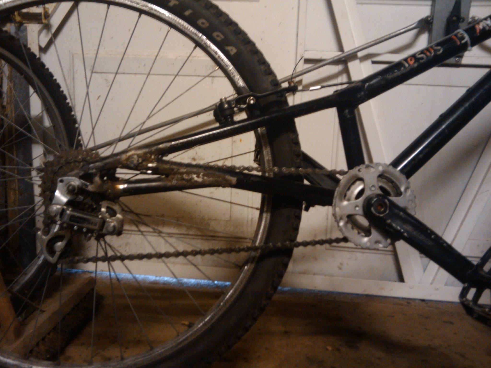

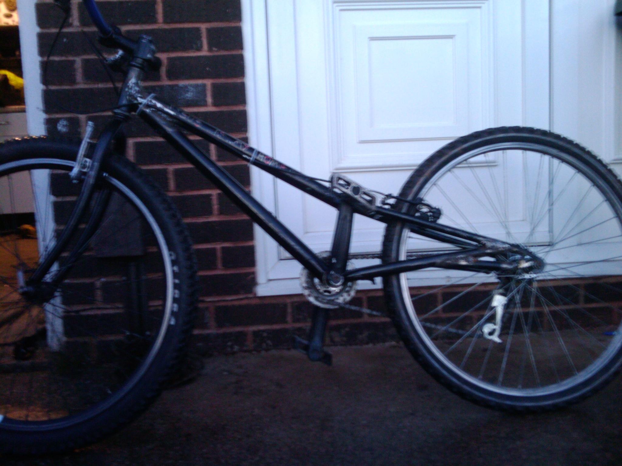

CurtisRider Posted April 16, 2010 Report Share Posted April 16, 2010 that looks like a old pashley!from a few years back Sam made it I also made a frame a while back, only took a few evenings Still going Quote Link to comment Share on other sites More sharing options...
Mr Motivator Posted April 16, 2010 Report Share Posted April 16, 2010 That's one hell of a headtube angle. Quote Link to comment Share on other sites More sharing options...
CurtisRider Posted April 16, 2010 Report Share Posted April 16, 2010 That's one hell of a headtube angle. The geo is all intentional, high bb and a short tt make this one of the funnest bikes i have ridden, spins and hops stupidly well Quote Link to comment Share on other sites More sharing options...
frayroberts Posted April 16, 2010 Author Report Share Posted April 16, 2010 Is it 20"or 26" as I can't tell It's 20" Quote Link to comment Share on other sites More sharing options...
Mr Motivator Posted April 16, 2010 Report Share Posted April 16, 2010 The geo is all intentional, high bb and a short tt make this one of the funnest bikes i have ridden, spins and hops stupidly well I wasn't on about yours, but yeah, yours it pretty upright. A bit like a frame I made once... Quote Link to comment Share on other sites More sharing options...
